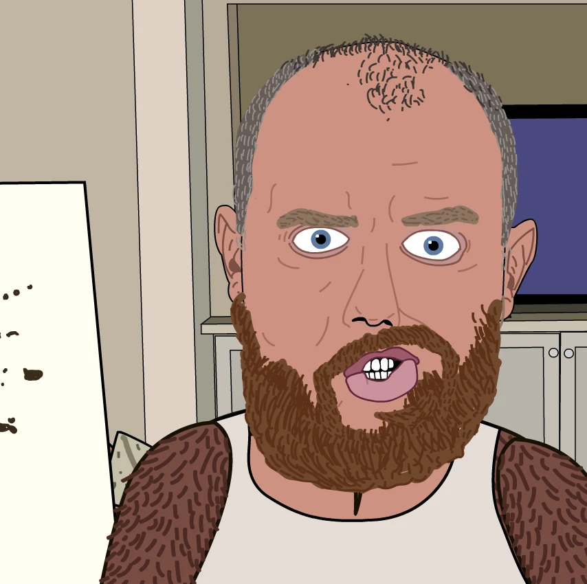

When I export in .SWF, the file of my animation looks like this.

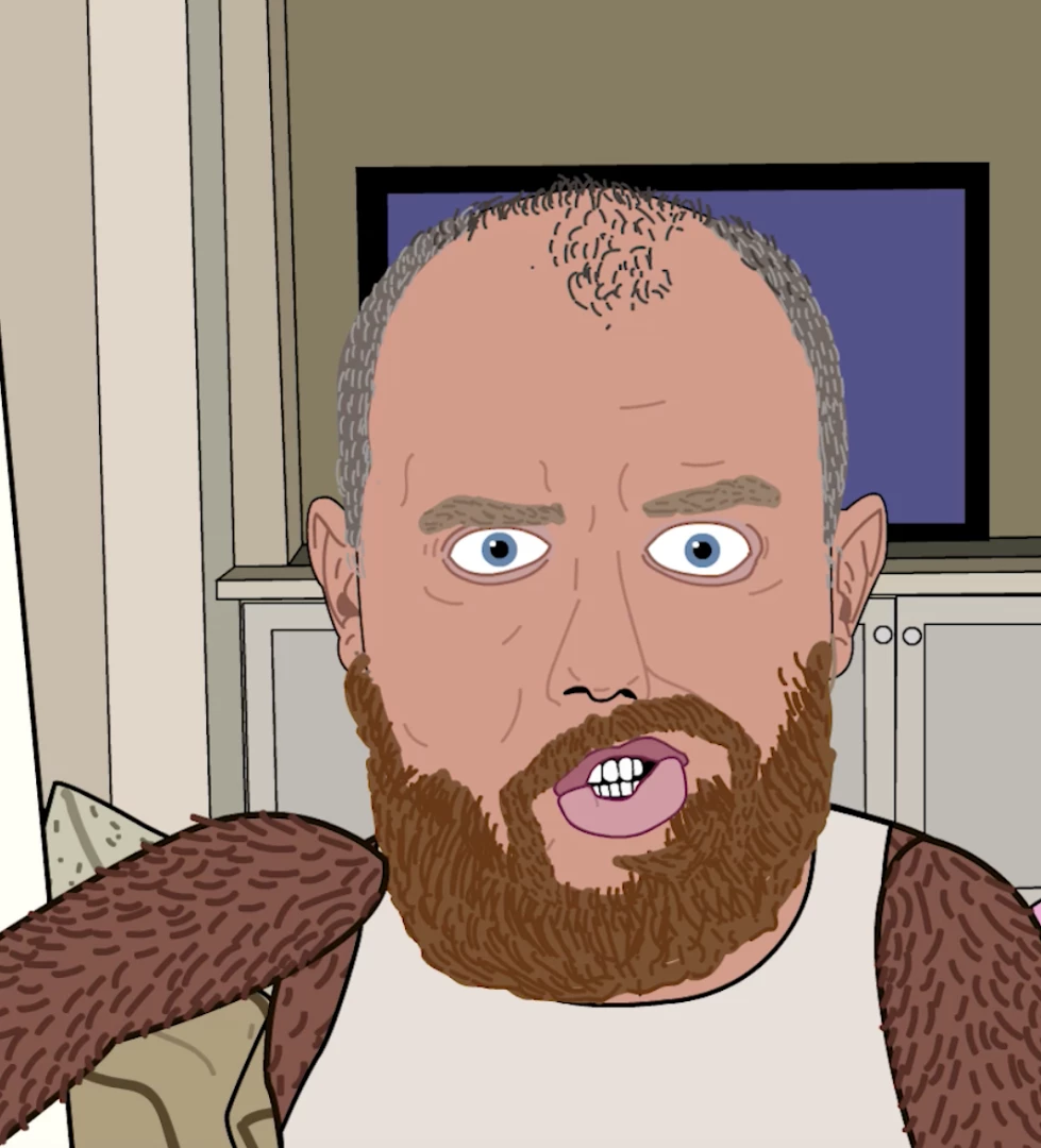

Using adobe animate 'export video' option, the quality turns into this:

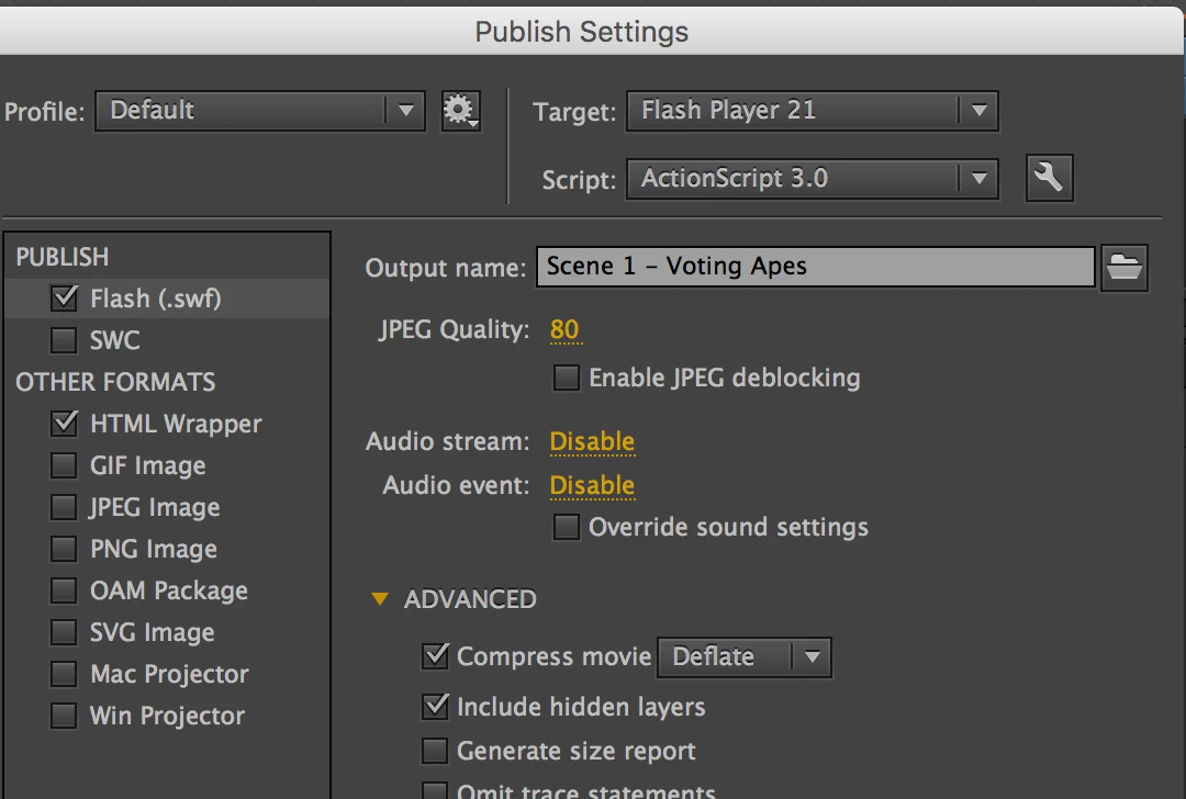

  • Use ActionScript 3.0. Animation created by ActionScript 2.0 and ActionScript 3.0 are different in playback performance. Convert the ActionScript in your animation to ActionScript 3.0 for optimized performance.
    (DONE, SEE IMAGE ABOVE)

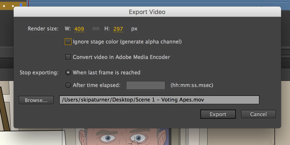

  • Dimension settings in two places. The dimension settings in Export Settings dialog sets the dimension of the SWF movie to be captured. The Size settings in QuickTime Settings dialog sets the dimension of the exported MOV files. If the SWF size is smaller than the exported MOV size, the picture quality will be degraded; if it is larger than the exported MOV file, you may have better picture quality. For best quality (and often performance) these settings should match.
(Is this how to change the SWF dimensions at "Properties W/H"?)
(Is this how to change the QuickTime Settings size?)
(If what I did was correct, I exported the .mov file at 409x297, when the SWF file was 1390x1011. The video file remains 'poor quality'.)

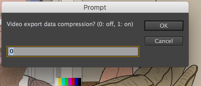

Changing the preference for temp data. During export, Flash compresses the export data when recording it to memory, allowing Flash to record longer content. This compressing process, however, consumes time, and may drop frames. Using a custom command, this preference can be toggled and turned on or off to help reduce that possibility. For a short, heavy content, it is recommended you turn it off and record the temp data to memory without compression. Otherwise, you should leave the option turned on. The command for changing this option is available for download below. You can run this command using the Commands > Run Command... option in Flash. Inputting a value of 1 will turn on compression while a value of 0 will turn it off.
(DONE)

When you export at that very low 409x297 resolution, obviously things will start to look fuzzy. It is too low resolution to retain sharpness in details. Try exporting your work at 1920x1080. Also, avoid the MOV format if you intend to release to the general public and use MP4 instead (unless you plan to put it on YouTube - doesn't matter that much then).
Generally animators tend to export to high resolution PNG files and edit and export the final movie file(s) in a dedicated video editor like Premiere.
PS Why did you decide to create your animation at a non-standard 1390x1011 resolution, by the way? Use 1920x1080 instead, for example. And export at that resolution as well.
