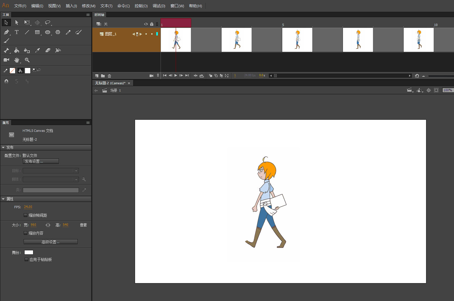

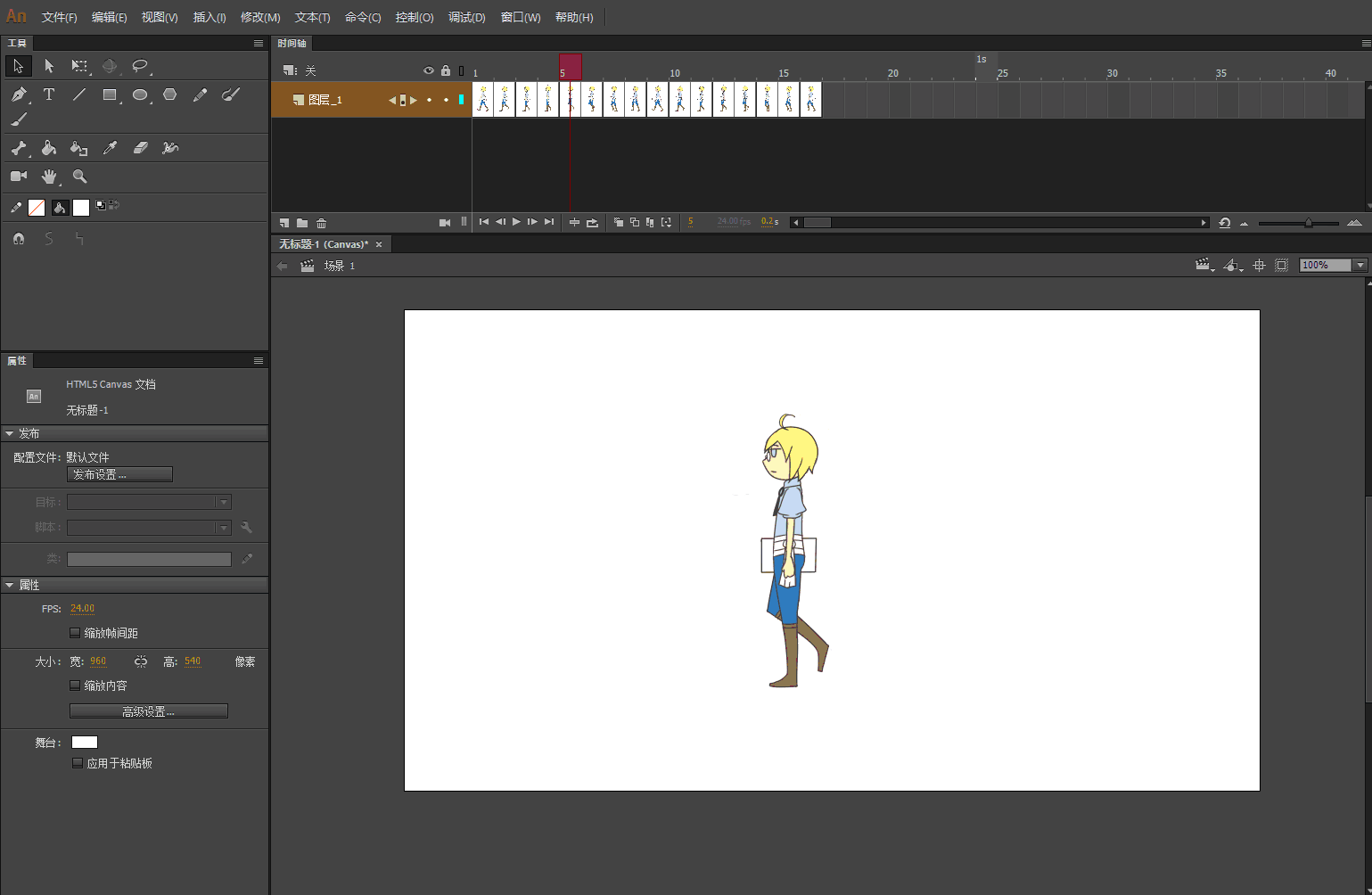

There are 2 ways of changing speed.
1,Select the frame range to be variable and drag at the edge
2,In the Properties panel, select Reduce frame spacing, then set frame speed, set what you want, and then cancel the frame spacing and change the frame speed back.(But this is a whole change.)

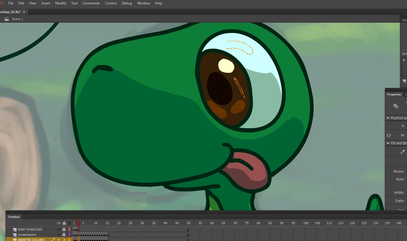

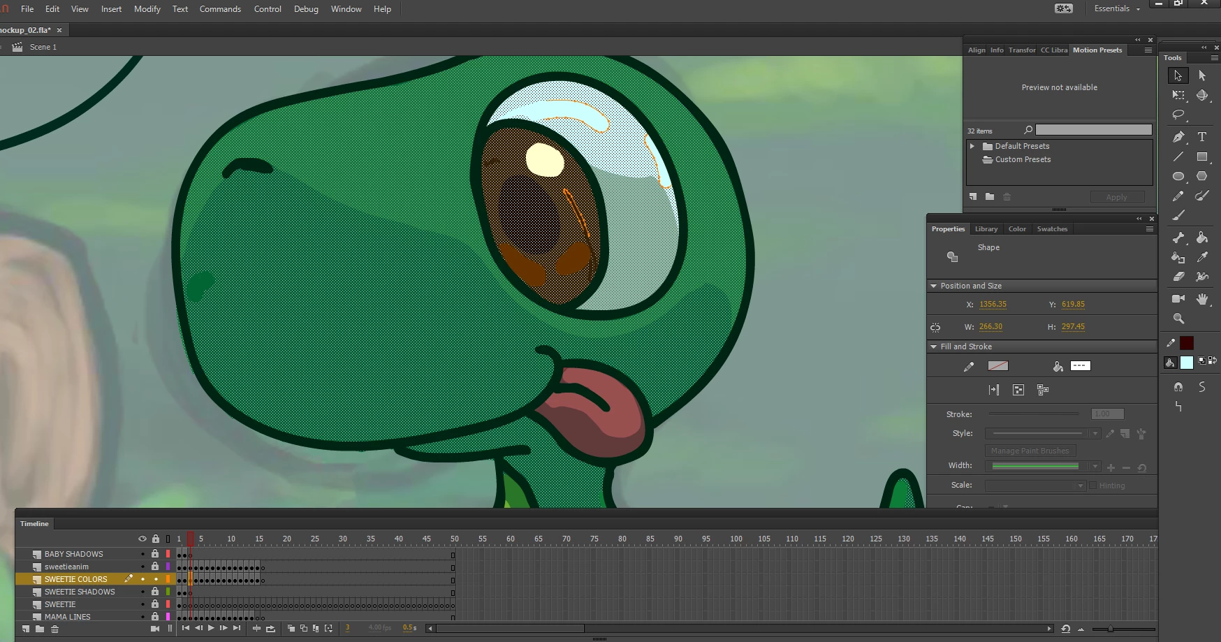

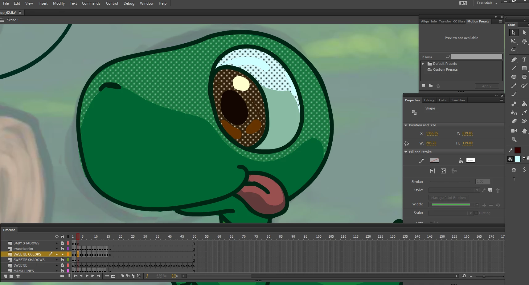

When I tried this, I kind of ran into more trouble. Upon combining objects together with union, they all become objects I can't draw over -- I'd prefer to be able to draw/fill on top of them. I also find I prefer them to be in parts. For example, I keep the highlights of different objects each in their own zones.
There seem to be 2 different kinds of things I can select -- objects and... the other thing?
This first shot is what I prefer to see when I select my colorings/lines:
For my purposes, this is actually what I don't want to see when I select any part of my line/fills:
If I do combine--> union, then everything seems to turn into objects I can't draw nor fill on top of if I wanted to. So what I've realized is that for my purposes, I really don't want my whole selection looking like this (both the object and the other thing included when I select all my coloring work in the same frame and layer):
I may not be an expert nor know all the proper terminology, all I really want is something that works.
