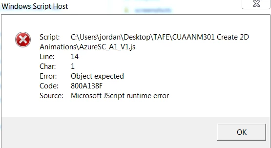

I'm trying to complete a small banner animation for my school assessment but keeping hitting a wall when publishing. My animation is made up of 4 images that are on screen for 4 frames while an mp3 audio file plays in the background. I can publish the HTML fine on my end, when i open it in browser it works. When I try to send it to my assessors or anyone else it opens to a blank screen.
When I opened the JS file I get the following error. If anyone could please help me it would be greatly appreciated. Thank you.

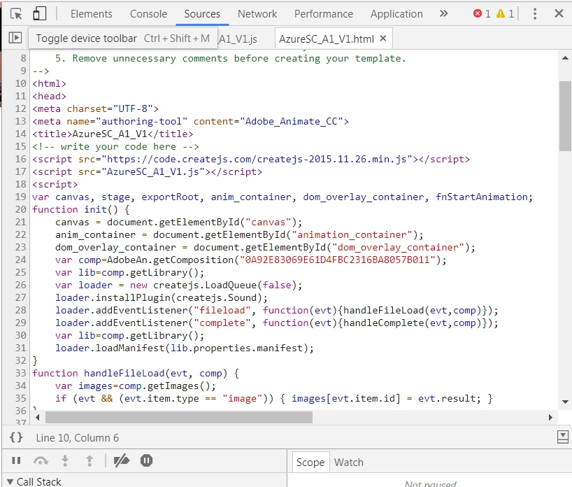

what are the first 20 or so lines of your js file?
December 4, 2017
Thanks for replying! I'm not sure where to find that information. I went into the developer tools within the web browser while the animation was running and found these lines of script in the source tab.
