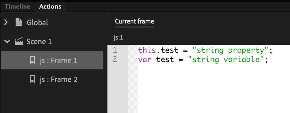

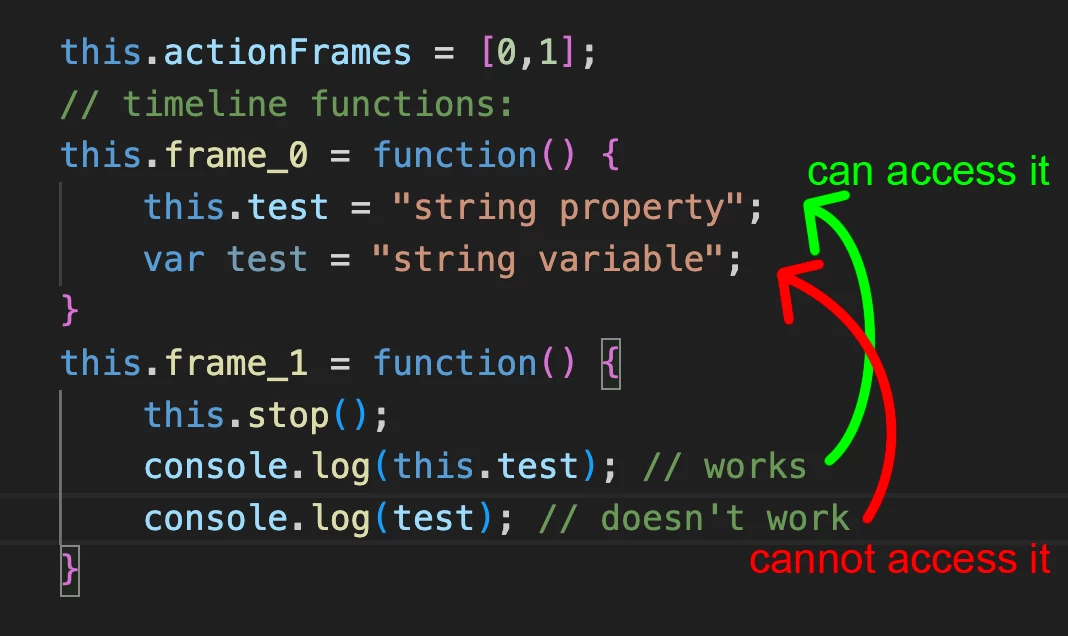

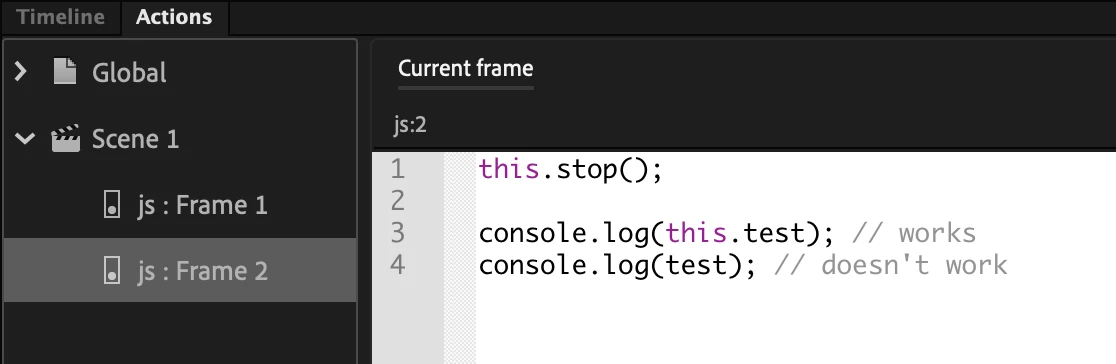

The main reason is related to scope. Animate exports the code we write in each frame as a separate method (a function tha belongs to an object). So if you declare a variable inside of a method/function (local variable), there's no way you can access it from outside this same method/function.
Code in the 1st frame of the main timeline:
Code in the 2nd frame of the main timeline:
Part of the code generated by Animate in the output (by default, <your_fla_name>.js :
Please let us know if you still have any questions.
