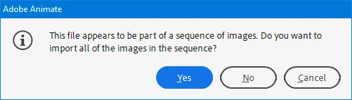

5. This dialog box appears:
Click Yes.
6. The sequence of images is imported each on its own frame.

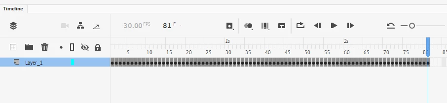

7. Go outside to adjust position and set the Graphic container to Play Once, if you need.
That's all.

I finally got a chance to try this after I had put all 120 frames singaly into work. I set up a new file I was able to import the cartoon exactly as you instructed. Thank you very much!
Sorry, the reply came a bit too late, but you will know for your next project.
