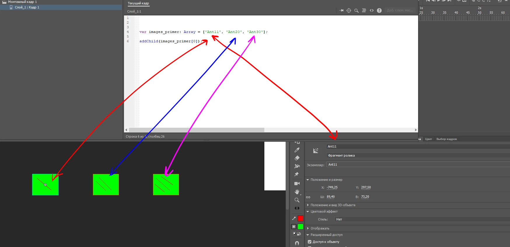

Unfortunately, it didn't help me. Maybe I asked the wrong question. When trying to add symbol MC (Ant 11) to the scene, an error occurs. All elements in the array must be a string (This is the main condition!). How do I convert a string to a property (I don't know exactly how it is called correctly, it is written in the instance name (Shown in the picture))?
var images_primer: Array = ['Ant11', 'Ant20', 'Ant30'];
addChild(images_primer[0]);
 An error is issued:  TypeError: Error #1034: Type Coercion failed: cannot convert "Ant11" to flash.display.DisplayObject.
at ABCD_fla::MainTimeline/frame1()
well, i certainly helped you.  you'll need to unnest those anonymous functions.
however, fixing that error won't fix other errors.
to that end, use array notation to coerce strings to objects:
addChild(this["Ant11"]);
or
addChild(this[images_primer[0]]);
