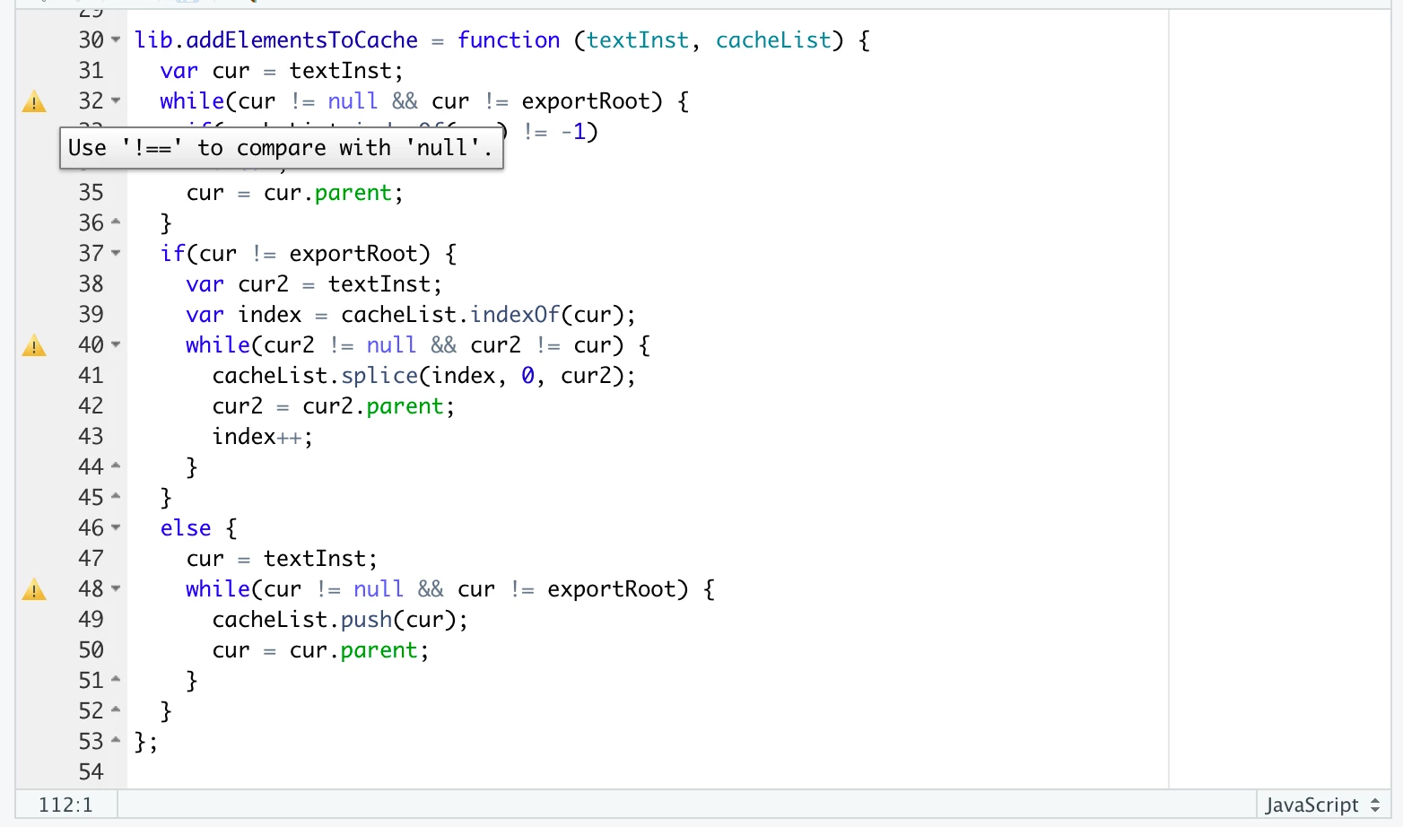

Hello Kglad, thank you very much for your reply! I really don't understand it... , here's line 17 of index.js:
{name:"index_atlas_7", frames: [[0,0,1026,1090]]},
My laptop automatically opened the index.js file in R, R gives blue round "i" icon for the lines afterwards saying "['index_atlas_7'] is better written in dot notation." I don't what does it mean either, but thought that might help?
R also gives many error reports in yellow rectangle, I've attached the screenshot below. I don't understand why it could go wrong... since I didn't write single line of codes but just add code snippets and wizard from the software.......
kglad
Sep 15, 2022 3:02 PM UTC
oops, my error.
that's line 3129 (17th space). paste line 3129.
and there are no errors in the screenshot you showed (though i have no idea what "R" means).
