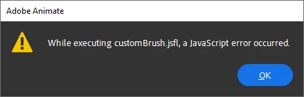

Unfortunately, that does not work either. I created a minimal command script using only the snippet you linked (wondering that maybe something else in my original script could interfere in any way with it), and I am receiving this error when executing it:
Here is the minimal command script:
if(fl.getDocumentDOM() != null)
    var theTool = fl.tools.activeTool;
    for(var s in theTool){
        fl.trace(s + " : " + theTool[s]);
I am using the up to date version of Animate (v 21.0.4).

i see this after selecting the 2nd tool on my toolbar and running that script:
sampleProperty : foo
position : 2
depth : 2
iconID : 0
and no error.
save that jsfl with name customBrush_v000.jsfl, open a fla and click command>run and navigate to customBrush_v000.jsfl.

you probably have an error after that line.  try:
fl.trace(s+" : "+theTool[s]);
