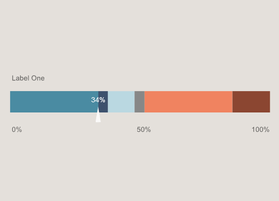

Hi.
This is the simplest slider I can think of. Please notice two things:
- The highlight is a timeline animation so it won't necessarlity match the position of the slider button. But the frames are set proportionally as expected.
- I used setTimeout to call the proportion function in the beginning to make sure the bar timeline will be ready when needed.
Preview:

Jun 1, 2018 12:16 PM UTC
Wow, that is really impressive. Thank you so much.
I will try my best to understand as much as I can but a lot of that is beyond my knowledge.
I can see where you reference the button and the dynamic text, but the rest ...
Would you have a link to where I can learn a bit more about the expressions you used?
Thank you once again.
JoãoCésar17023019
Jun 1, 2018 12:35 PM UTC
Excellent! I'm sure you're gonna understand all of this very fast.
You can take at look at CreateJS's official docs and especially in this mouse interactions tutorials:
EaselJS Tutorial: Mouse Interaction
And you can also look for general JavaScript tutorials on Lynda.com and YouTube, for example.
