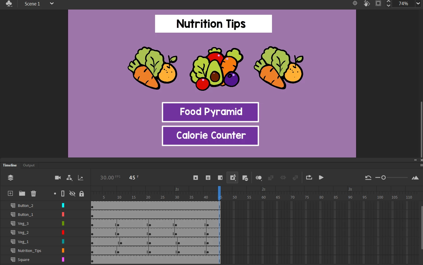

Hello, Im still new to adobe animate and I wish I could get assistance on how to solve this problem.
I created three different scene and I want the buttons that I created on Scene 1 be able to navigate to Scene 2 and Scene 3. So I click on the button , choose action script To go to Scene and play and input the scene number I want the button to navigate. However it not working and I keep getting errors. Is there anything I can do to solve this? And what could I miss here?
Really appreciate for any help !

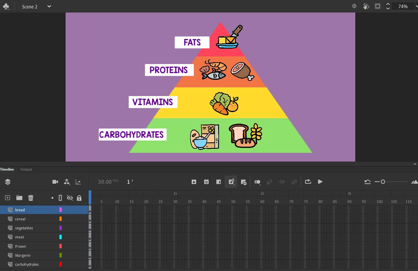

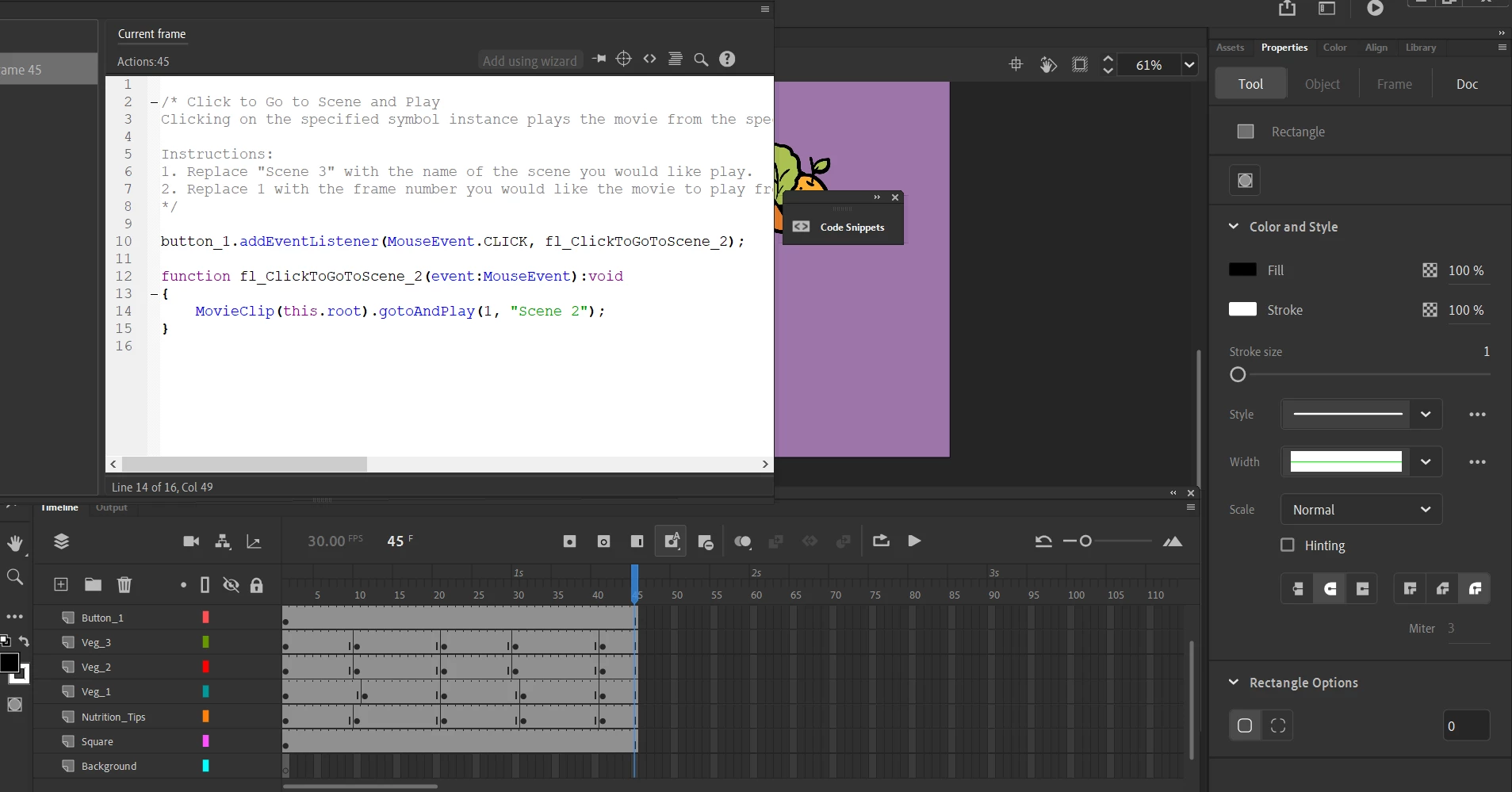

    January 28, 2022
    Thanks! I just put some frames on Scene 2 then run the code Go to Scene and Play. However encountered an error with the lines below :
    ArgumentError: Error #2108: Scene Scene 2 was not found.
    at flash.display::MovieClip/gotoAndPlay()
    at wani_Scene1_fla::MainTimeline/fl_ClickToGoToScene_4()
    what could be the problem and is there I should not miss to properly run this?
