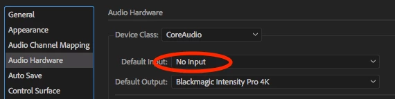

canadarm001
September 15, 2018
Using souped up Mac Pro 2009 with a Blackmagic Intensity Pro for output to my amp (Mac OS Sierra -10.12.6). Working from PrPro to select my audio tracks to edit clips in Audition, everything loads but Audition won't playback UNTIL I discovered that if I select NO INPUT in my Audio Hardware settings in Audition, THEN I can swap between PrPro and Audition with full sound playback capabilities in both softwares.
Worked for me..hope it helps.
