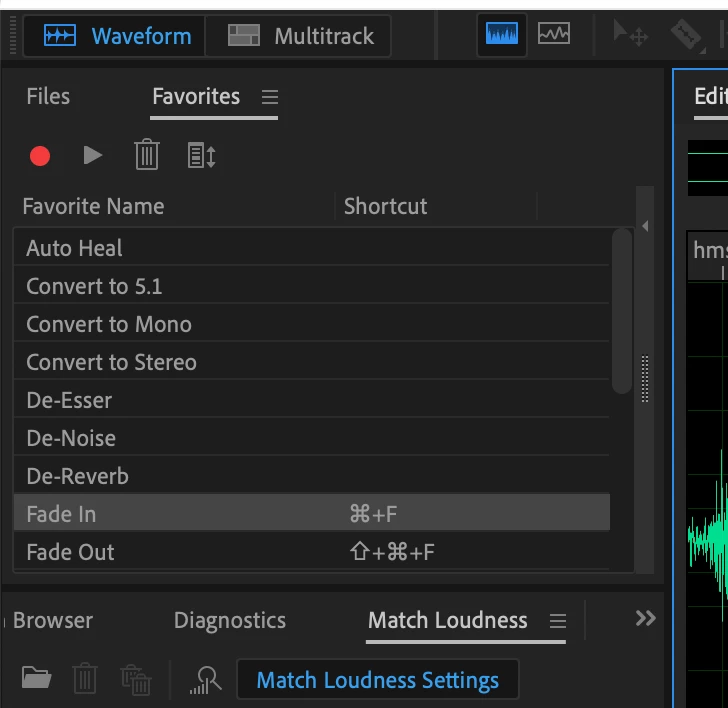

    I seriously used fade in and fade out at the beginning of this year w/o going to multitrack, because I’d never used multitrack until April, and I’ve definitely been fading in and out in waveform for several years while using the “edit clip in audition” feature in premiere. Had shortcuts for fade in and out and everything. Is this the Mandela Effect in action? What’s going on? Lol
    Sep 17, 2026 12:07 AM UTC
    Alright, idk what the difference is, and it doesn’t matter, but there is this “Favorites” on the side, with a separate Fade In and Fade Out that do exactly what I need, and I was able to assign them my shortcuts again, so I’m back in business. PHEW.

    Nothing’s going on at all. The effect that you can apply only to a clip in Multitrack view, and a Favorite exclusively for use in Waveform have no relationship to each other. That’s all you need to remember. And no, nothing about this has altered for a very long time.
