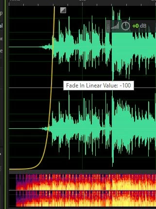

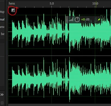

    The HUD is in the View menu, but it's slightly misleading to say that this is what you use really, as there's an even simpler way using the fade handles on the track itself, and it's very flexible. It looks like this (ringed in red):
    You can drag this about, and it will put variable fades onto your track that are outlined in yellow: If you drag the mouse down you can change the linear value and have a pretty steep fade if you want. Works the other end of the track too.
