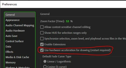

    SteveG(AudioMasters)​ I tried running AA with hardware acceleration on and off (restarting before each time.) Alas, it made no difference that I could tell, either way.

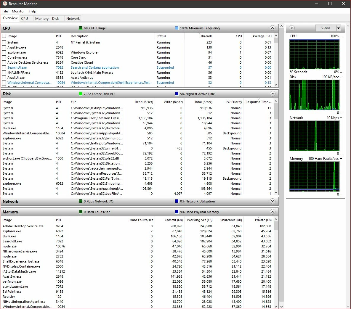

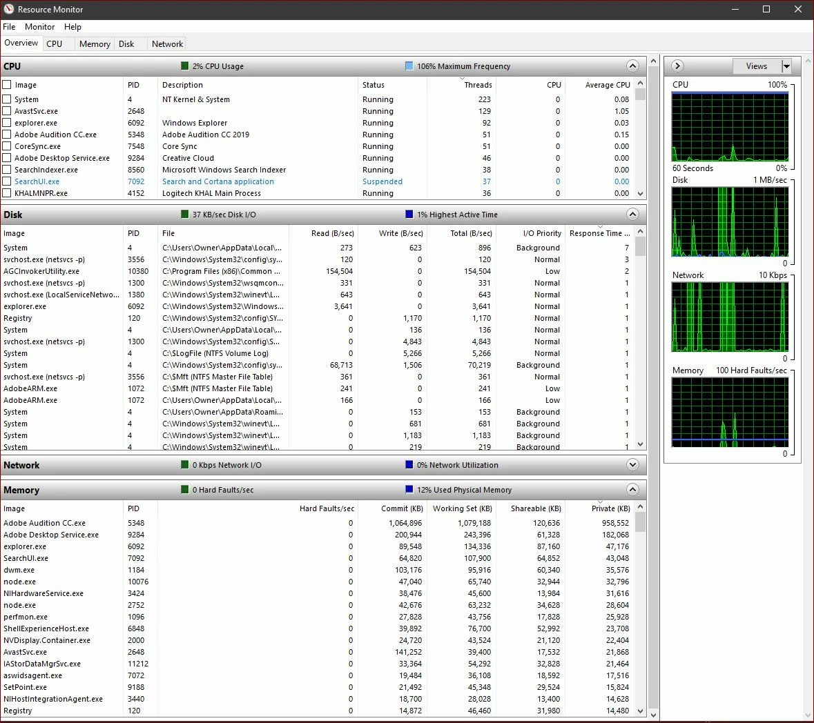

    Travelor​ As creating a multitude of smaller WAV files instead of using just one is problematic in other ways (since I'm working collaboratively with others) that's a very undesirable solution. I'll put off trying that one till last. Meanwhile, I restarted my computer, opened the Resource Monitor, and took a snapshot. Then I opened AA, ran it a bit (and it's as sluggish as ever), and took another snapshot of the Resource Monitor. I'm not sure what I'm looking at, though. Does anything strike you as problematic?
    Before:
    After:
    SteveG_AudioMasters_

    Ah... in that case try turning the Hardware Acceleration on if it's off, and vice versa - see if that makes a difference:

    Hopefully this is the resolution. It is one of the area's that I mentioned in my post regarding the Graphics on the PC. The developers included some code in Audition to take advantage of the Graphics chip/memory. I am relatively new to Audition and it'a a good thing we've got a Master in our presence..
