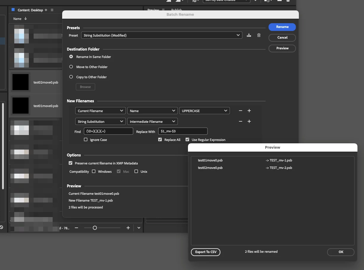

Aug 13, 2024 3:54 PM UTC
It would be helpful if you could provide more than one before/after filename example...
There are variations on the following, this was just the first thing that I knocked together, there might be better expressions:
Find:
(\D+)(.)(.)(.+)
Replace:
$1_mv-$3
Bridge Batch Rename screenshot:
EDIT:
I prefer this variation on the original Find regular expression:
(\D{1,4})(.)(.)(.+)
or
(\D{1,4})(\d)(\d)(.+)
Stephen Marsh
