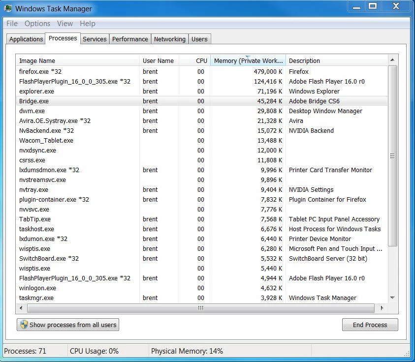

Found the work around answer. Start Task Manager - go to Processes - find Bridge cs6 - click 'end process'. Bridge will now open. I have to do this every time to use Bridge - but at least it works again. (win 7/ 64 bit)
