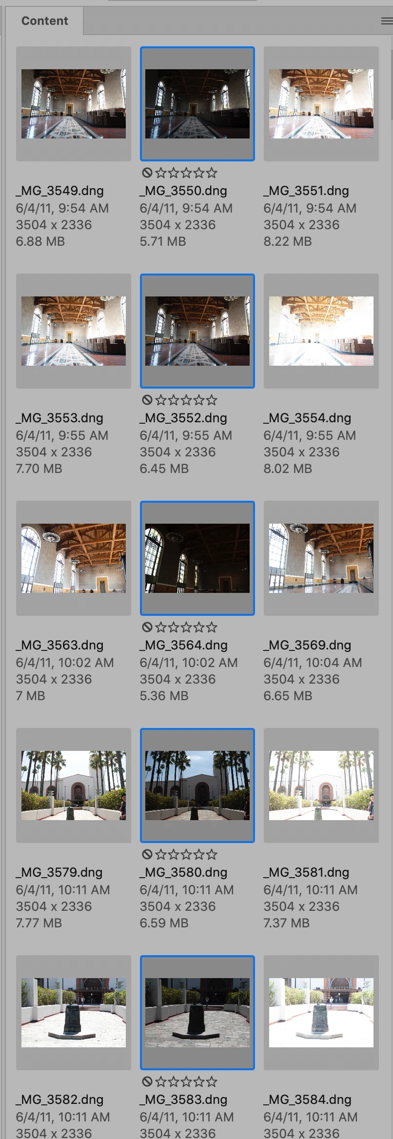

I think I have a solution but that's only if the exposures were taken in succession. That is: -2, 0, +2; then -2. 0, +2; etc. If that's consistant than you could set the Content Panel to three wide, then quickly Command/Control-click on all the middle ones. Then give them a colored lable and move to the next group.
Something like this:

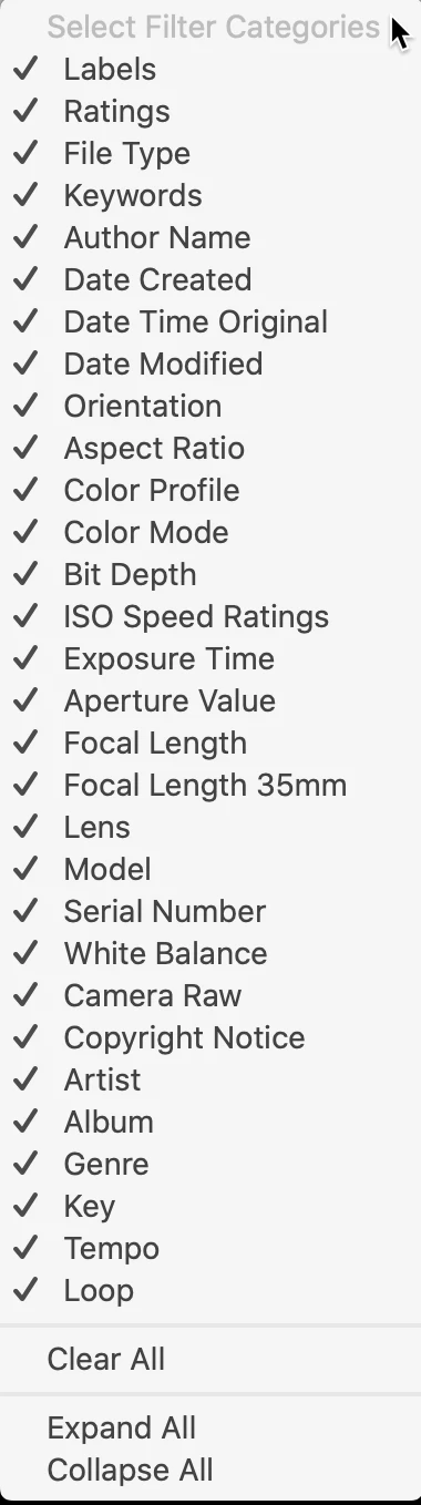

In Bridge, you can filter by:

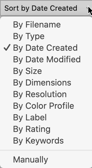

You can Sort by:
So the answer is (unfortunately) no.
