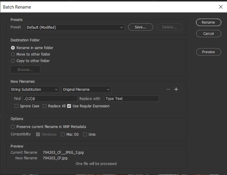

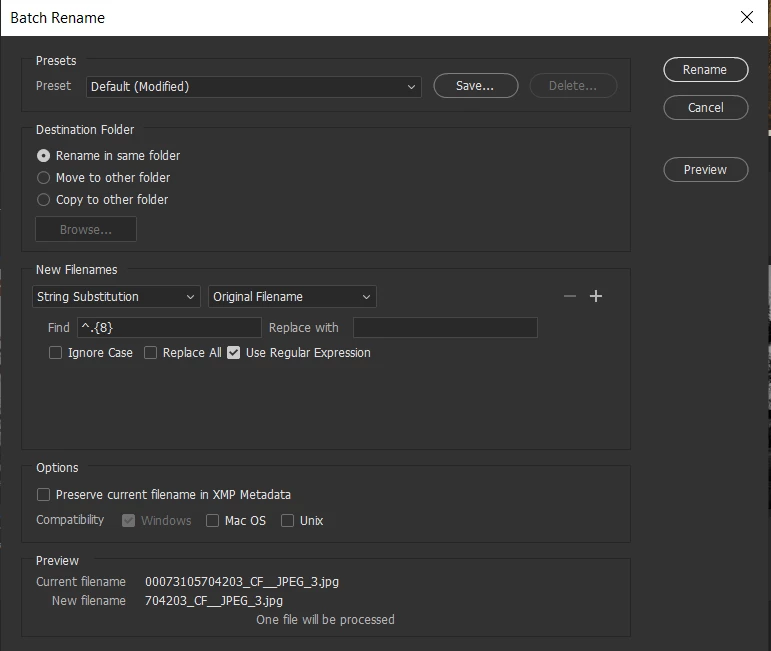

Sep 15, 2021 3:28 AM UTC
You can use batch rename with string substitution and regular expression in Bridge to do this.
I found a way to do it in two separate operations. Perhaps someone else here can suggest a way to combine them into a single operation.
Step 1: remove first 8 characters
^.{8}
Step 2: remove the last 12 characters
.{12}$
MigintoshAuthor
Sep 15, 2021 4:05 AM UTC
Thanks, that's very helpful. The first pass removed the 8 characters I wanted from the front, but the second pass left 4 of the characters I wanted to delete at the end. I changed the Find to .{16}$ and it got all 12 characters in the second pass. Do you know why that is?
I'm going to play with it for a while and see if I can get it to work in one pass, but if anyone knows how and wants to post it, I'd appreciate it. I'd also like to add 3 characters back in at the end to have 12345_CF.jpg, so if I can do all 3 in one go, that would be best.

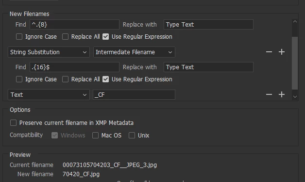

gregreser
Sep 15, 2021 5:11 AM UTC
Sorry, I didn't notice that you need on less character before "_CF"
I found that I could add a second parameter using "intermediate filename" which made the edit in a single pass.
Then I added a third parameter to add "_CF".
I think this works:
