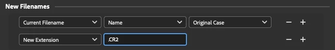

Without seeing your original Batch Rename settings it's hard to comment. Adobe have made it quite hard to accidentally change the file type extension in regular use of Batch Rename.
Did you tick/check the "Preserve original filename in metadata" option when Batch Renaming? If so, you can restore the original filename and extension... Or just add the correct extension back in again to the required file type using Batch Rename, I'm guessing that this was a raw camera file?
