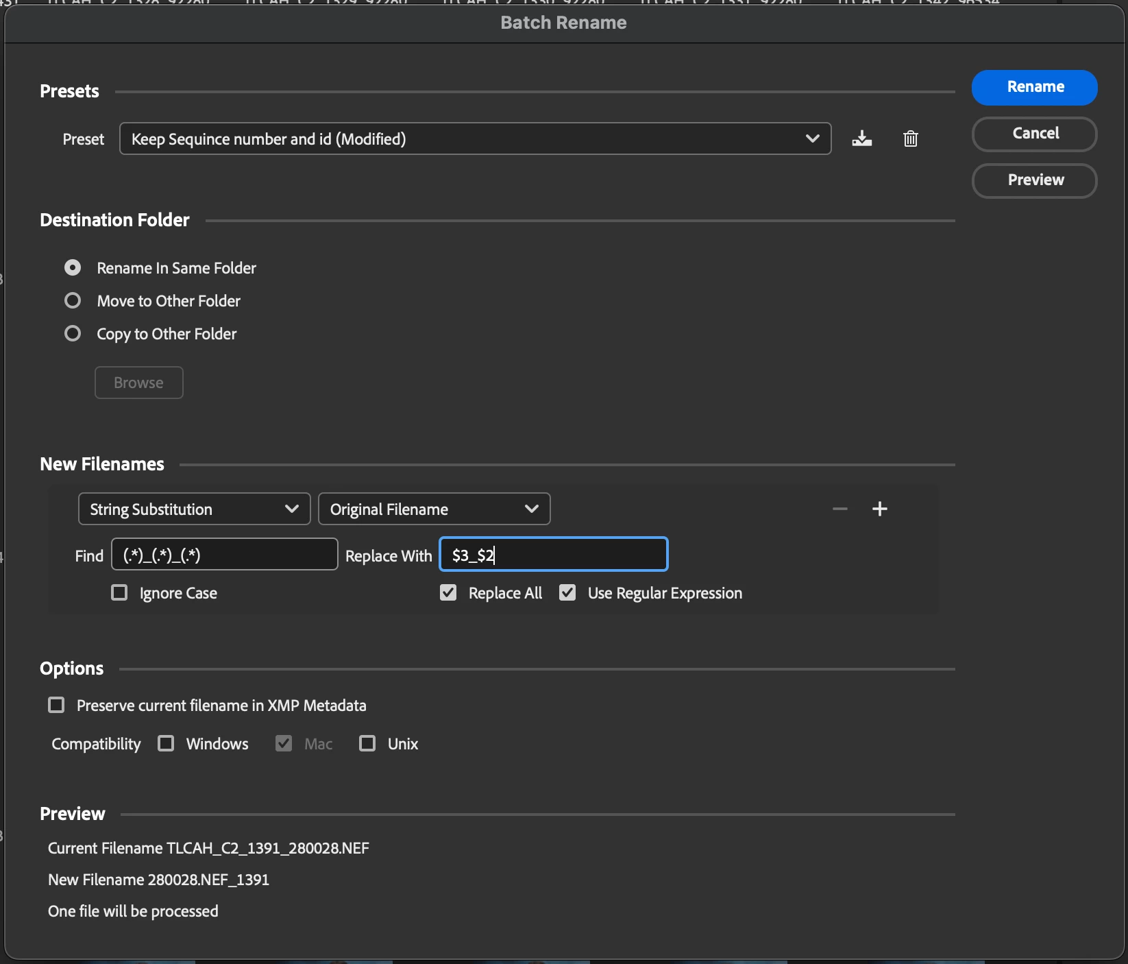

i an trying to do a batch rename.
i am trying to get the 4 digit number after the 6 digit number.
With my curent expression it puts the 4#s after the NEF.
i have tried to create a new sequence number after $3 and it still goes behind the .nef
Anyone have a work around?
Here is a screen shot if that helps.

To put the 4 digits after the 6 digits with the rest of the name the same:
Find:
(.+_)(\d{4})_(\d{6})(\.[^\.]+$)
Replace:
$1$3_$2$4
Or if you only want the 6 digits, underscore, 4 digits:
Find:
Replace:
$3_$2$4
There are other valid find expressions, such as:
(.+_)(.+)_(.+)(\.[^\.]+$)
(.+)(_)(.+)(_)(.+)(_)(.+)(\.[^\.]+$)

Please type out the before and after names so that your request is crystal clear.
