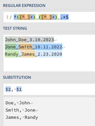

The Regular Expression find/replace:
Find:
^([^_]+)_([^_]+)_.*$
Replace:
$2, $1

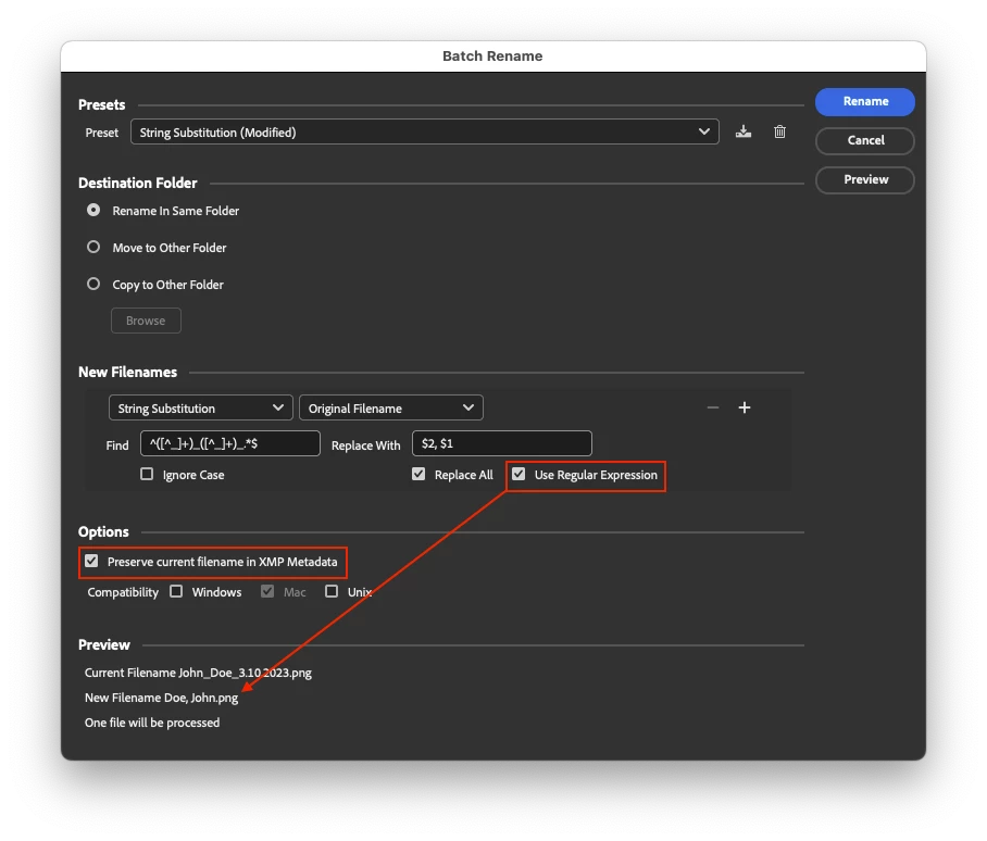

Using Bridge's Batch Rename tool with the String Substitution Regular Expression option:
Find:
Replace:
$2, $1
Mar 27, 2025 12:53 PM UTC
Wow! This is amazing! I just tried it and it works! What d a HUGE game changer! Thanks so much for this! I appreciate you. You make a difference in this community!

Multiple valid regular expressions can be used, that was just one example.
