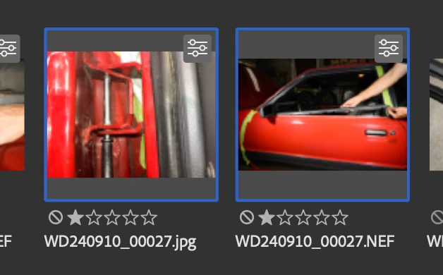

Batch Rename of unrelated RAW and JPG files have same number
Batch Rename of a folder that contains both Nikon Z8 raw (NEF) files and iPhone SE jpgs for some reason gives them the same name. The files are shot at different times on two different devices, but for some reason Bridge thinks they're related?
The issue is when I export these files, the images ovewrite each other. What's gong on here? Seems like a bug to me.

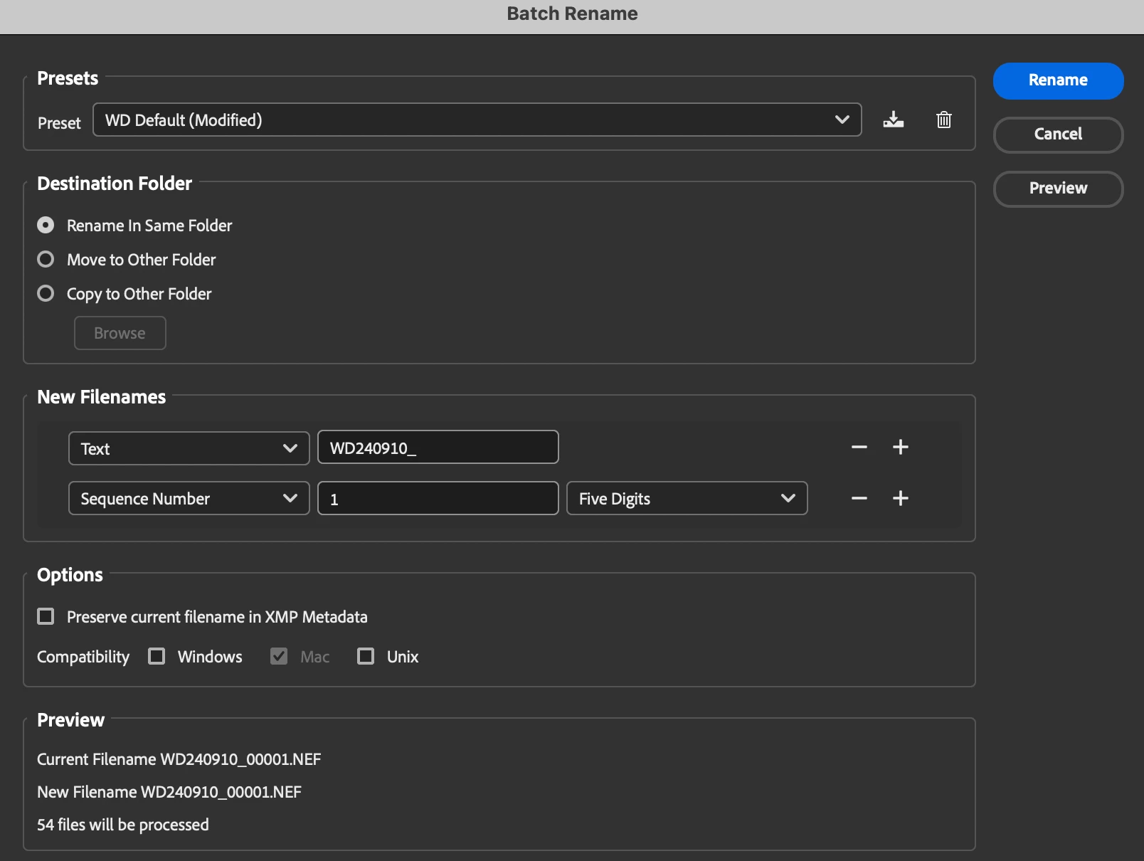

Can you post a screenshot of the Batch Rename settings?

Not anymore. Beforehand, the image names were totally different. I sort the images "By Date Created" and then rename them. The images are not sequential, as my camera and phone clocks are not synchronized.
"Can you post a screenshot of the Batch Rename settings?"
Attached

My Test Results (v2024, Intel Mac):
I just tested with a mixture of raw and jpg file with different names sorting by date and the preview button and the actual rename result was correct, they were all treated as separate files each with a new individual sequence number.
