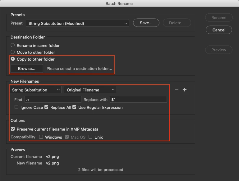

To try stop rename problems, I'd suggest that you play things safe in the future:
* Manually backup the originals first, or use the Batch Rename feature to copy the files to another directory
* Embed the original filenames in the XMP metadata so that they can be recovered if things go wrong (there is a preset to restore the preserved filename, the key is to preserve it first)
* Use the preview button to open up the window to double check all files, don't trust the quick preview at the bottom 100%
It is quicker to restore/recover backups than to try to rename a rename that had issues.

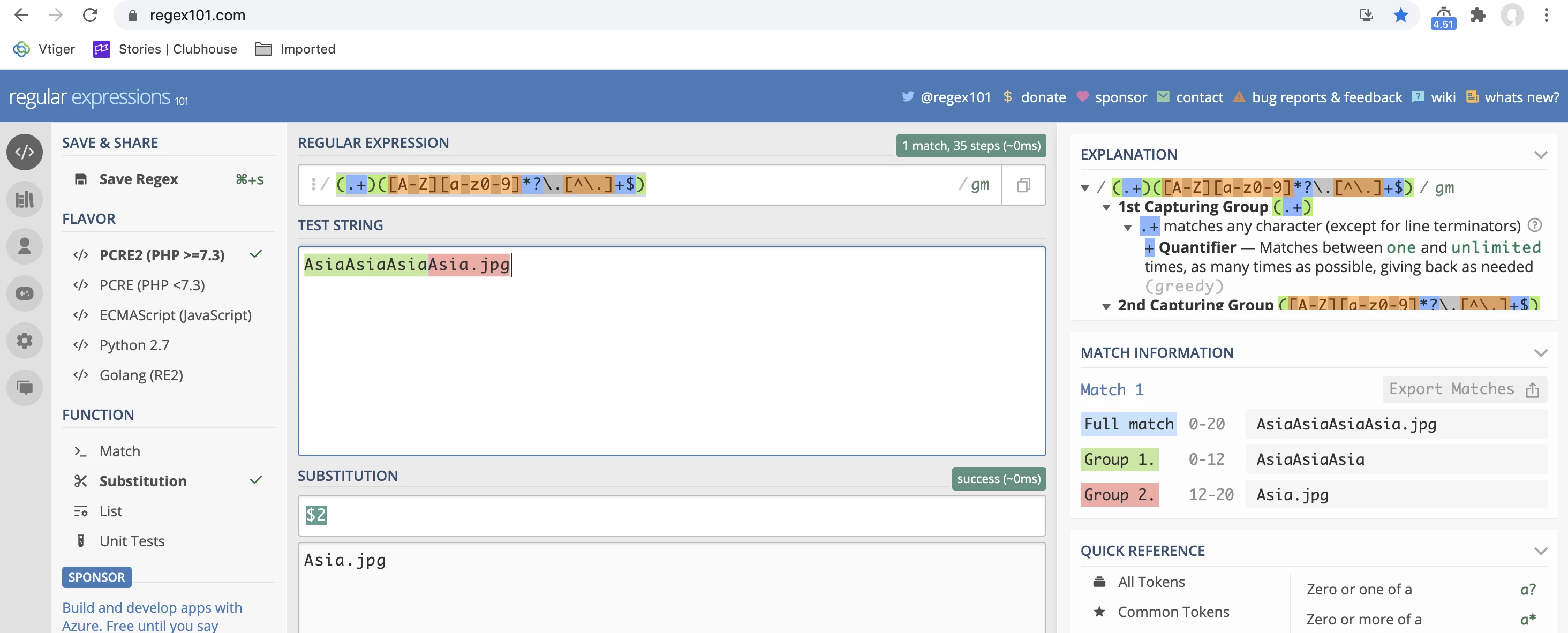

For example, if I presumed that the pattern:
Was always the first 4 characters from the left, or the last 4 characters from the right after the file extention... But that would not help for EuropeEuropeEuropeEurope.jpg
If your pattern is an uppercase letter followed by varying lengths of lowercase letters, then one of my previous suggestions works:
Find:
(.+)([A-Z][a-z0-9]*?\.[^\.]+$)
Replace:
$2
