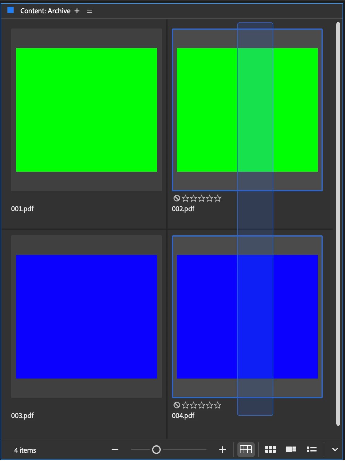

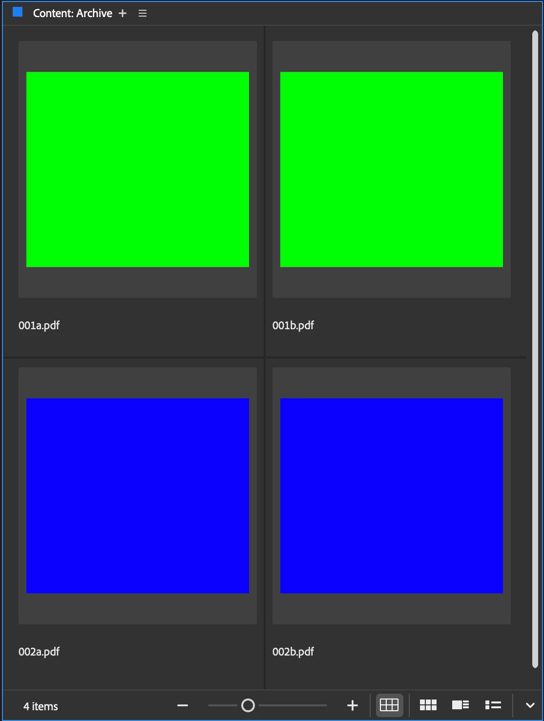

Here is a low-tech, non-scripted solution. In the following screenshot, Bridge is sorting in filename ascending order in the grid "thumbnail" view, with the preview size and window content set to force a 2-column view. All one has to do is drag a selection marquee over all files in the right-hand column to select the even-numbered files (yes, dragging down to scroll over 400 odd files). I'd suggest adding a colour label before or directly after renaming the first set, then you can use the filter panel to hide these labelled files (as the sort order will likely change). Afterwards, one can Edit > Invert selection to select all odd-numbered files and reset and run the sequential rename again with a different prefix or suffix.
Example of selecting the even-numbered files:
Final result after both batch renames:
