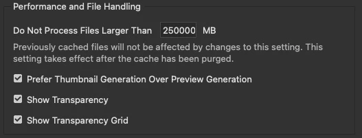

Bridge 13 preview large cache issue
Brdige 13 will not preview large psd / psb files.
I have large psb files and have no issue in Bridge 12 when the thumbnail size is increased from 1,000mb to 250,000 mb (Do not process files larger than...)
It would seem that the increase does not register as when I test I can see everything less than 1,000 but nothing over.
I've reverted back to 12

The mentioned issue is fixed in the latest patch release #13.0.1.583. Please install and confirm if that fixes the issue.
You can refer to the issues fixed in the patch at the following link https://helpx.adobe.com/bridge/kb/fixed-issues.html
