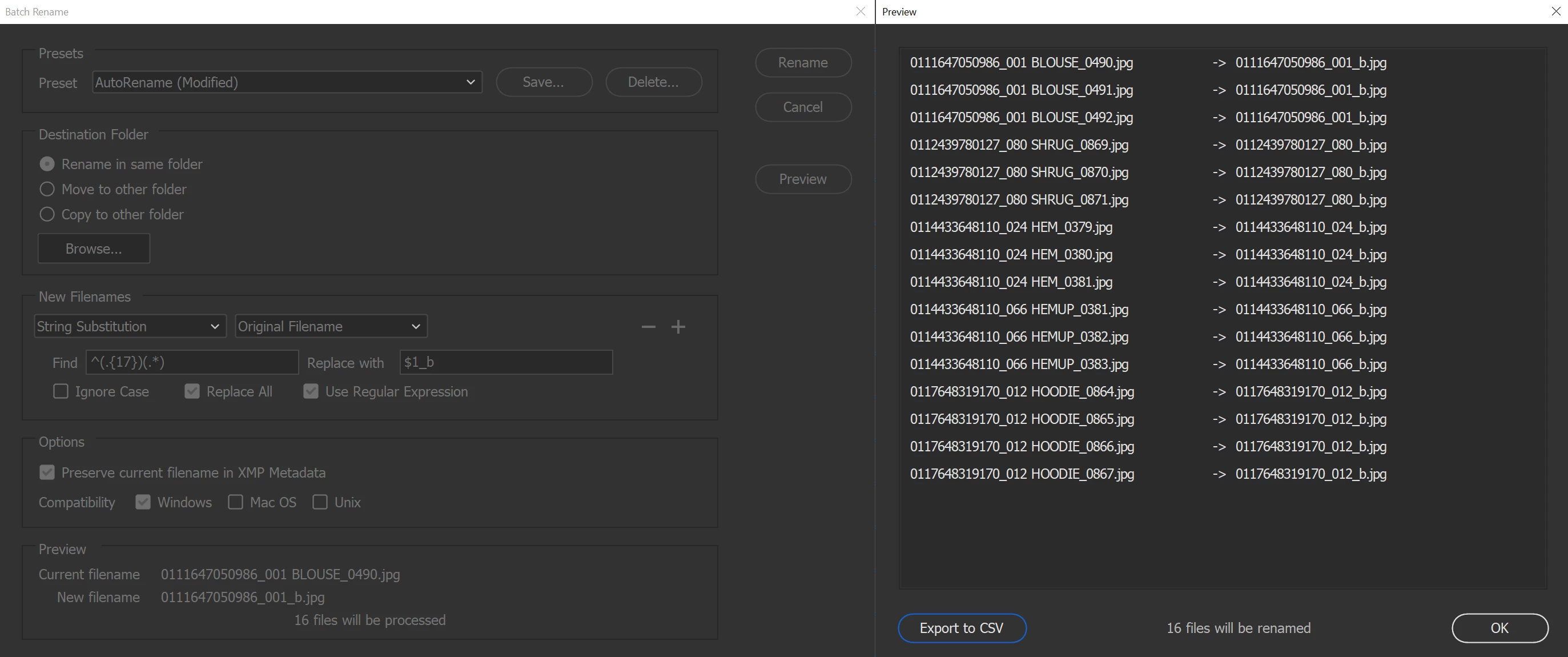

Step 3 - Run AUTO_RENAME_01 (this is just what I call my saved batch rename setting) using the attached screenshot settings.
FIND: - ^(.{17})(.*) REPLACE: $1_b
What this is doing is basically renaming all of my images.
From the following;
To the following;

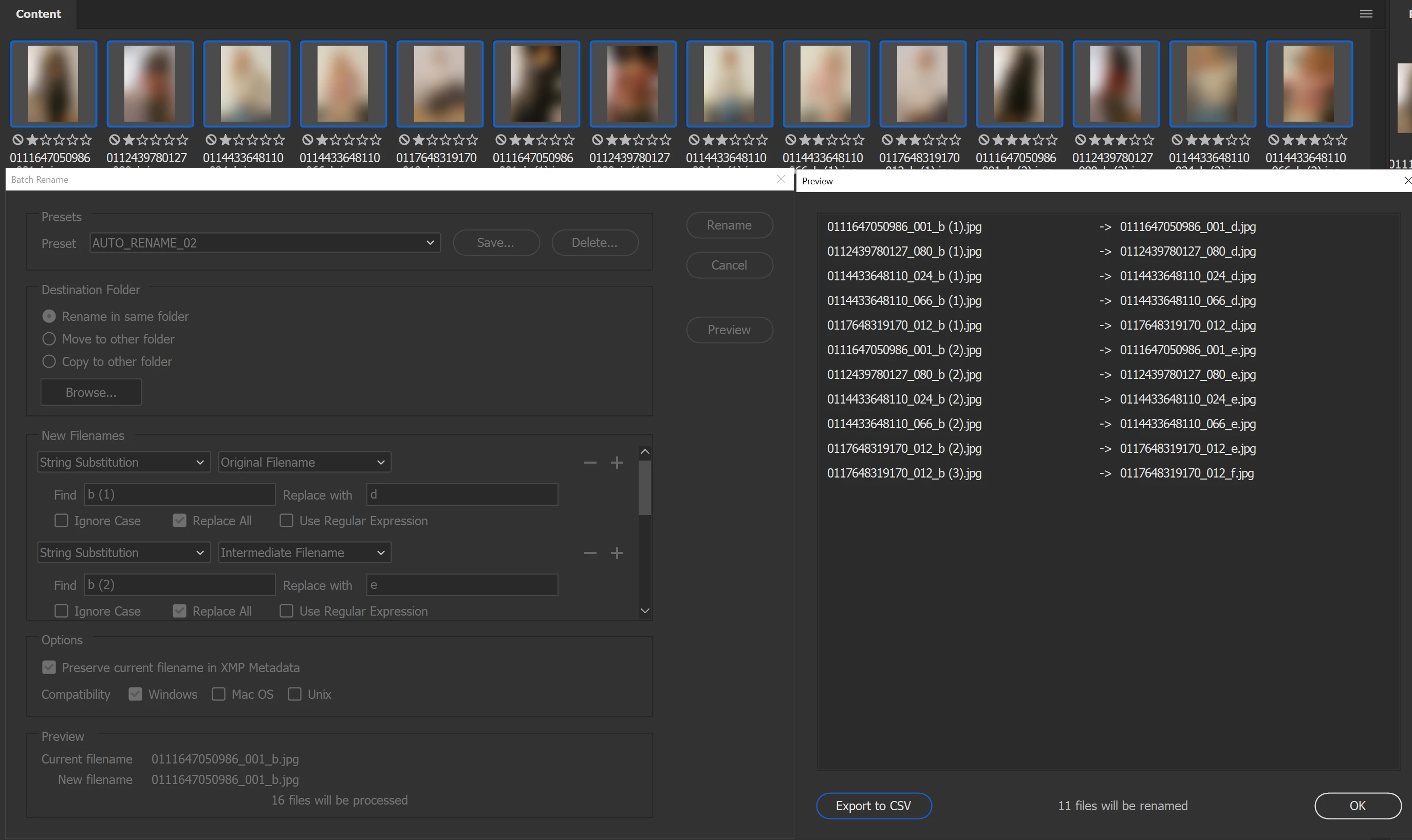

Step 4 - Run AUTO_RENAME_02 (this is what I call my secondary batch rename) and its just a series of String Substitutions; as following.
String Substitution - Original Filename
Find b (1) Replace with d
String Substitution - Intermediate Filename
Find b (2) Replace with e
Find b (3) Replace with f
Find b (4) Replace with g
Find b (5) Replace with h
This is the end of it since I never use more images with the same code that would result in anything past h.
What this is doing is basically renaming all of my images a second time.

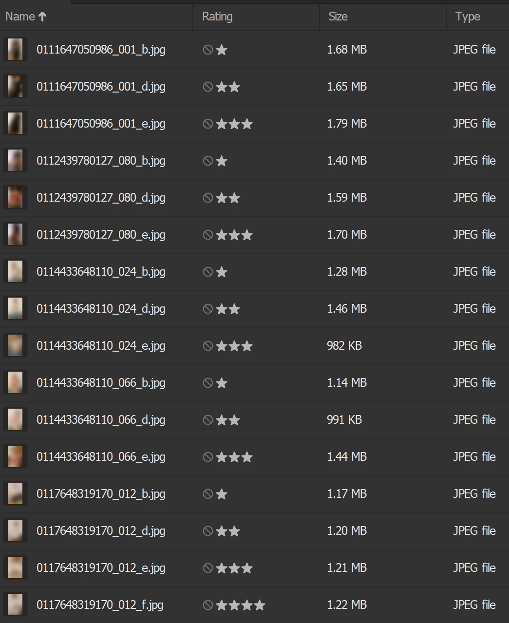

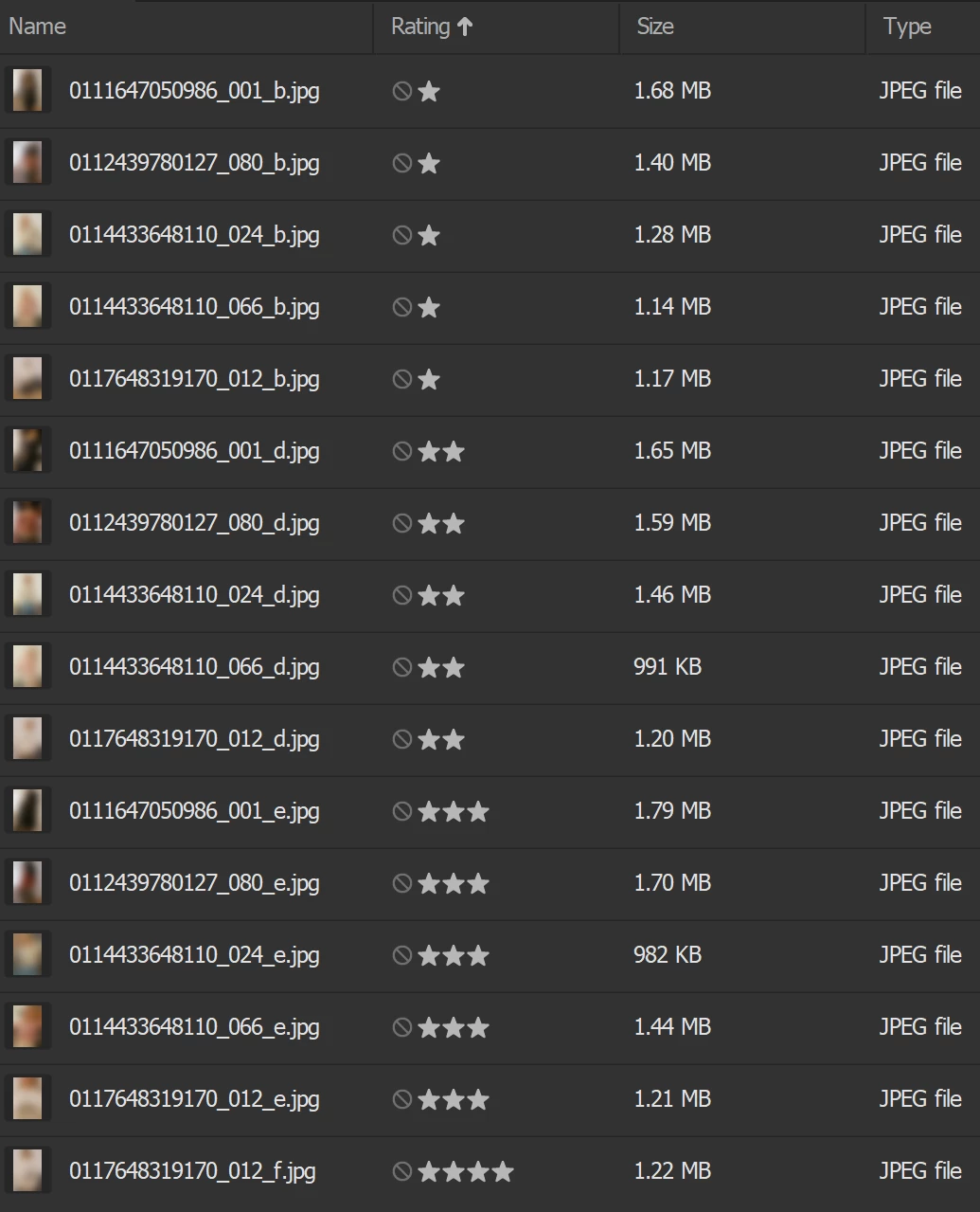

Here are two screenshots of the final result. Since the result is sort by rating - it shows all of the b first then e then etc. However if I re-order back to sort by filename (on the second screenshot) you can see the result is that each unique 17 digit code is followed by _d _e _f _g
