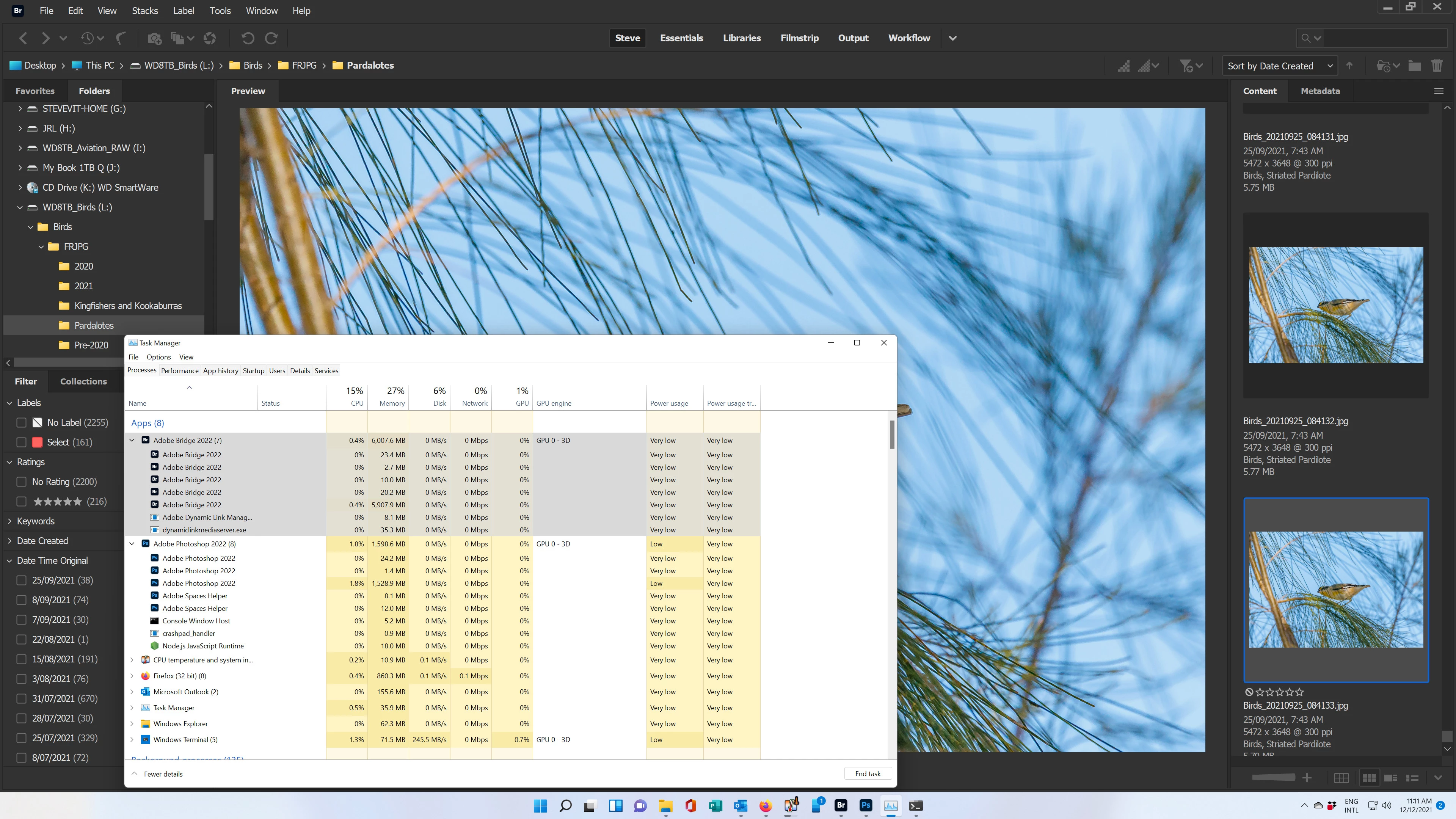

Dec 12, 2021 2:17 AM UTC
I'll tell youy what else is different about the latest versions of PS and Bridge.  Have a look at y7our task manager if you're on Windows 11.  Is it like mine?  Never used to show all these processes.
