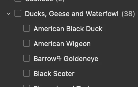

Jan 18, 2023 1:42 PM UTC
I've discoverd that apostrophes were a problem in Bridge vs 12.0.3.270. Although the list fully imported the apostrophes were replaced with a special character. In the picture below it should read Barrow's Goldeneye but if you look you can see the special character that's been inserted.
