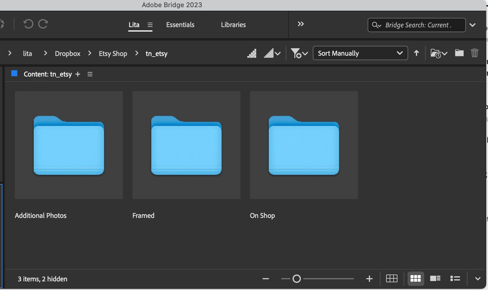

Nov 10, 2022 7:59 PM UTC
Also having trouble with Manual Sorting in Bridge 2023. Some folders were manually sorted in Bridge 2022 and when opened in Bridge 2023 they revert to a filename sort even if set to Sort Manually. Reverted to Bridge 2022 for now but this is not optimal.

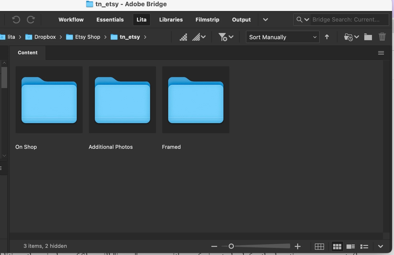

Nov 10, 2022 8:11 PM UTC
Here's a simple example of my issue (which may not be the same as James27016626srdd):
Bridge 2022 Manually sorted:
Same Folder opened in Bridge 2023 - ignores my manual sort and does a filename sort:
