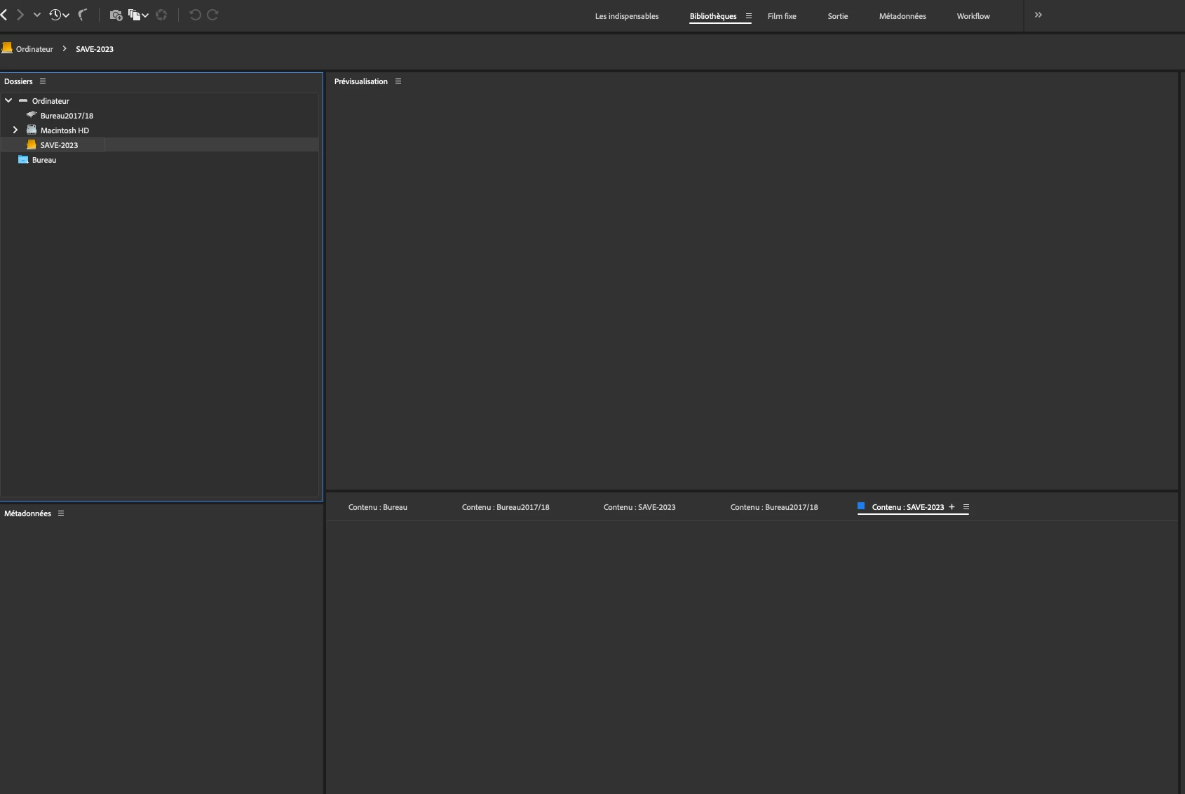

Hello Shivani,
Thank you for your message.
My operating system is Mac OS Sonoma.
As you can see on the screenshot attached when I selected the external disk, for example, nothing appear in the window.
When I first open the software I din’t confirm the access of certain files or external disk, and now I want to change it.
Thanks for your feed-back.
Olivier

Hi, @Olivier Currat, I "think" you are having a permissions issue. Please confirm that the follow is what you needed. (Note: the dates in this are from last year, but the issue will always be there.
This sounds like you've not given Bridge permission for Apple's protection. Simply, this is an Apple protection issue, not Adobe's issue.
Go into the System Preferences and select the Privacy & Security tab on the left. Note that there are two options on the right you'll need to deal with: "Files and Folders," and "Full Disk Access."
First, going into Files and Folders, note that in various years of different releases of Adobe Bridge, different needs are needed. I do not know why this is, but it's always better to check and make sure that just because you did it for one release, you may or may not need it for a subsequent release.
Lastly, go into the Full Disk Access option. If you do not see your application in the list, click on the "+" symbol at the very bottom of the window. This will bring up a standard Finder window. Navigate to your Applications Folder, find Adobe Bridge, and add it to the list (You will need to add your Administrator's password to do this.). Then you can "switch" it to the "ON" position.
Please let us know if that works or not.
