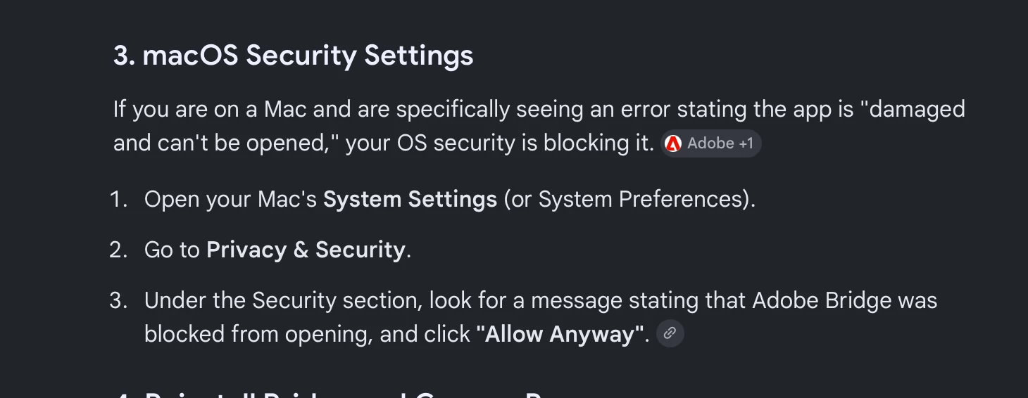

    lesleytreloar
    Jun 6, 2026 3:48 PM UTC
    This worked!
    lesleytreloar
    Jun 6, 2026 3:47 PM UTC
    I had the same problem and did this and it worked!
