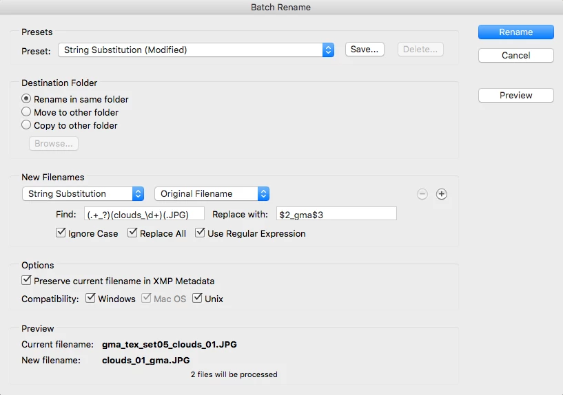

Stephen Marsh
Jan 16, 2019 5:13 AM UTC
An old topic, but still worthy of a reply for others in a similar situation...
There are of course many suitable regular expression find/replace variations:
(.+_?)(clouds_\d+)(.JPG)
$2_gma$3
(.+_?)(clouds_\d+)(\.[^.]*$)
$2_gma$3
(?:.+_?)(clouds_\d+)(.JPG)
$1_gma$2
