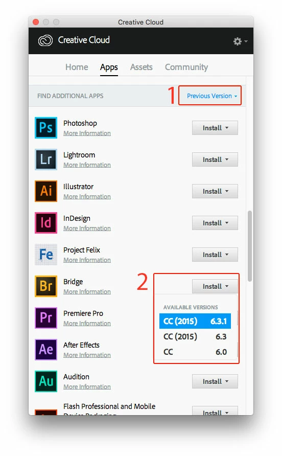

I understood that your other Adobe applications are not upgraded to 2017. You may install and use Bridge 2015 so this way Bridge can communicate with the rest of your cloud applications.
You may follow below steps to access older Bridge version.
