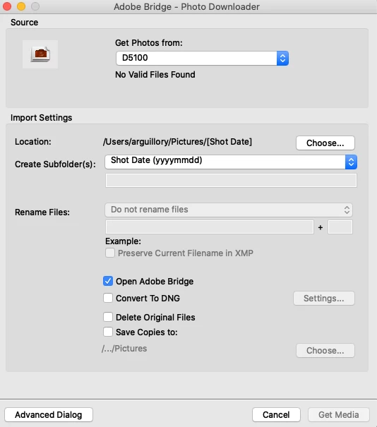

Bridge CC "No valid files found" on camera Mac OS Catalina v 10.15.2
I'm currently unable to upload files to Bridge CC from my Nikon camera.

If you're having issues accessing external drives, card readers, cameras, etc. AND you are on a Mac using Catalina or Big Sur do the following:
Go to your System Preferences and select Security and Privacy (found in the top section). Now click on the Privacy setting (last tab). Now click on the lock on the bottom left and provide your Administrator code. Now select the Full Disk Access option and click on the "+" symbol. This will bring up the standard Mac Open window and let you add any application you want or need to have full access. Look for Bridge, select it, it will now appear in that window and make sure it's checked. Next go to the Files and Folders option and do the same thing as above (although there's nothing to check, just add. Close everything down and see if that makes it all work.
