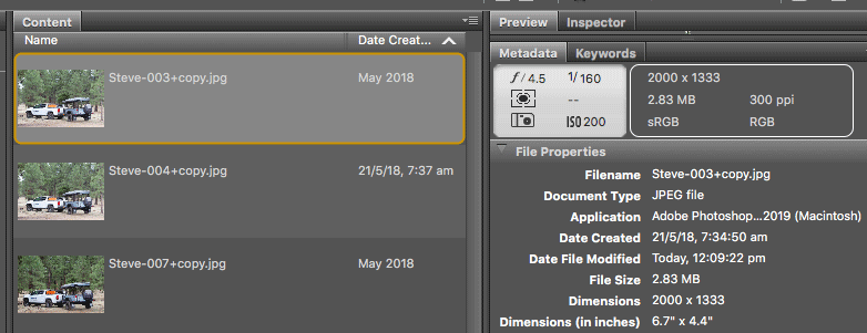

Can you share some sample files? The content does not matter, they could be 1 pixel images, it is all about having intact metadata that shows the date created date/time.
I just did a quick test in CC2018 and it appears to sort correctly by time on the date created column.
Jan 16, 2019 12:55 AM UTC
Hi Stephen, Thanks for getting in on this. Here are a few files. I've checked several dozen of the files from various shoots and they all have the time and date in the metadata. I'm wondering if there's something I've set wrong in preferences, or something? I can't figure it out.
Stephen Marsh
Jan 16, 2019 1:17 AM UTC
Here is an animated GIF of a sort on the date created field, the metadata panel on the right lists the date & time which appear to be sorting sequentially in the correct time order as all shots are from the same day:
