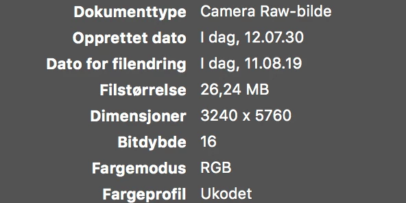

Bridge changes the dimensions on my photo
I use Capture One for digitalising photos and then I use Bridge and Photoshop for editing. I didn't have any problems yesterday but today, when I open the files in Bridge, Bridge changes the file dimensions from 3840x5760 to 3240x 5760. It looks like 16:9 ratio. I can´t find any place where I can correct that. Anyone who has any idea?

    Thanks to you all for trying to help me. I really appreciate it. :-D
    I think I just solved the problem. When I take pictures with Capture One and using the "normal" trigger, it works fine, but when i use the trigger in the "Live View"-window (so I can see that I put the photo correctly) the settings are for 16:9. :-&
    So I just use the normal trigger and everything is fine.

    Ok, I don´t open the files in Bridge, just view them, but nevertheless, when I use Finder to view them the files are ok.
    But in Bridge the Fileinfo says:
    and it is the same file.
    They are RAW-files, so they open i Camera RAW.   3240x5760.
    Mar 22, 2018 7:47 PM UTC
    Bridge does not change file dimensions. And you can't open files in Bridge, you can only view them in the Bridge browser. What does Photoshop show as the dimensions when you open it there? Have you gone back to C1 to see if you mixed up your dimensions?
