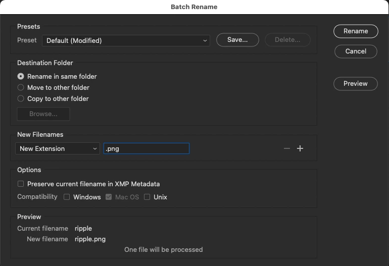

Can you share a screenshot of your Batch Rename settings that caused this issue?
If all of the images were the same file format (all TIFF, or all JPEG etc), then you can batch rename as illustrated here:
Otherwise, you may have to work out which files are the same format and rename in smaller groups with the correct extension.
