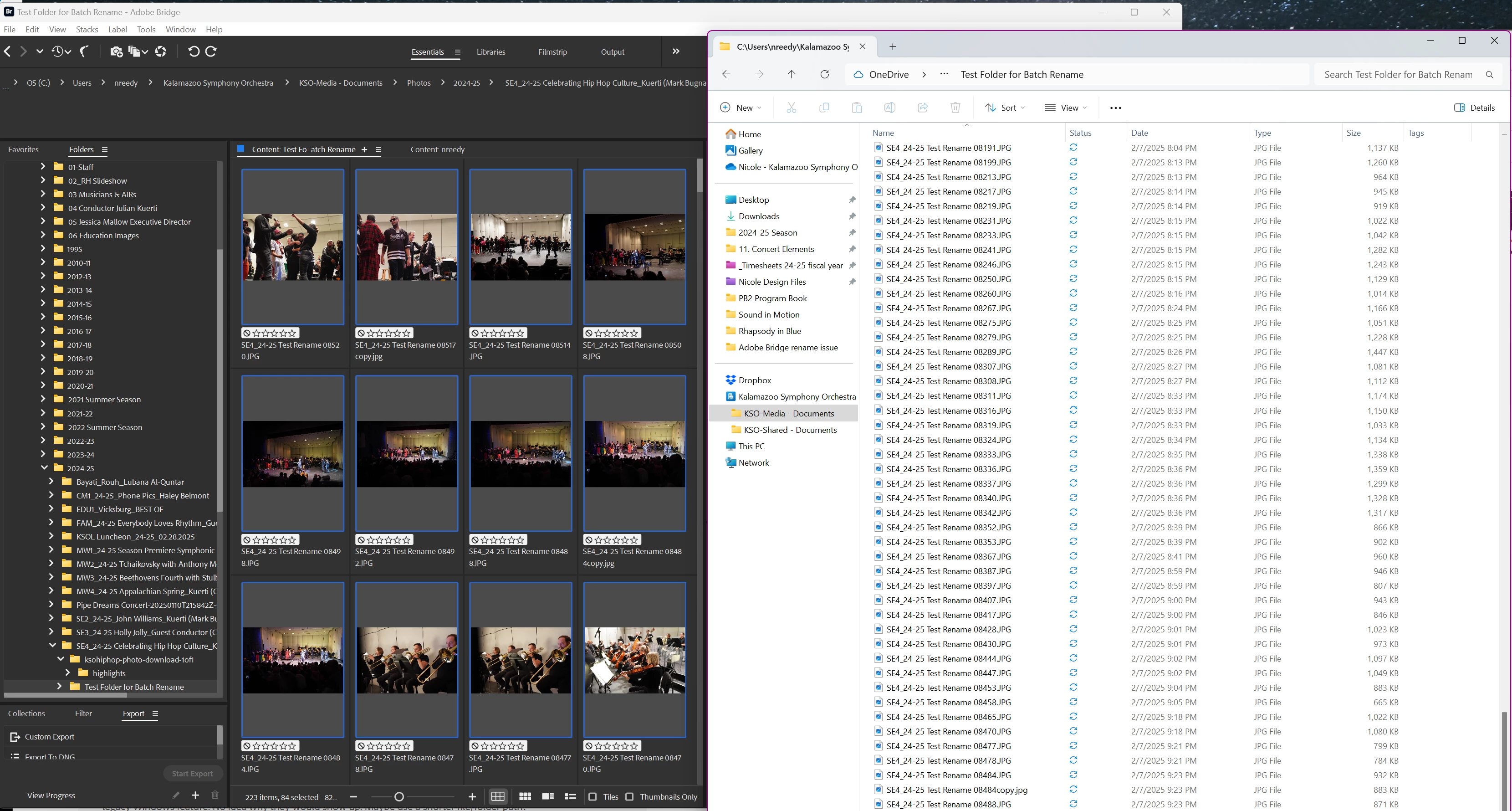

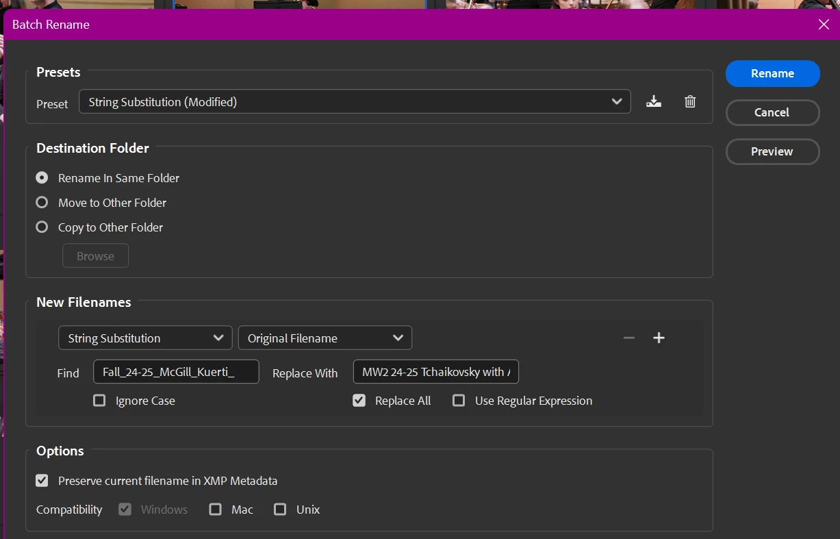

  • Screen shots show:
    • 1. correct filenames that show up in Windows Explorer
    • 2. random filenames that appear in Bridge
    • 3. Batch rename settings

  • is that showing correct in Preview section at the bottom of Batch rename settings dialog, Please share the complete screenshot of Batch rename settings dialog
  • Please share a sample file
Your assistance is greatly appreciated!

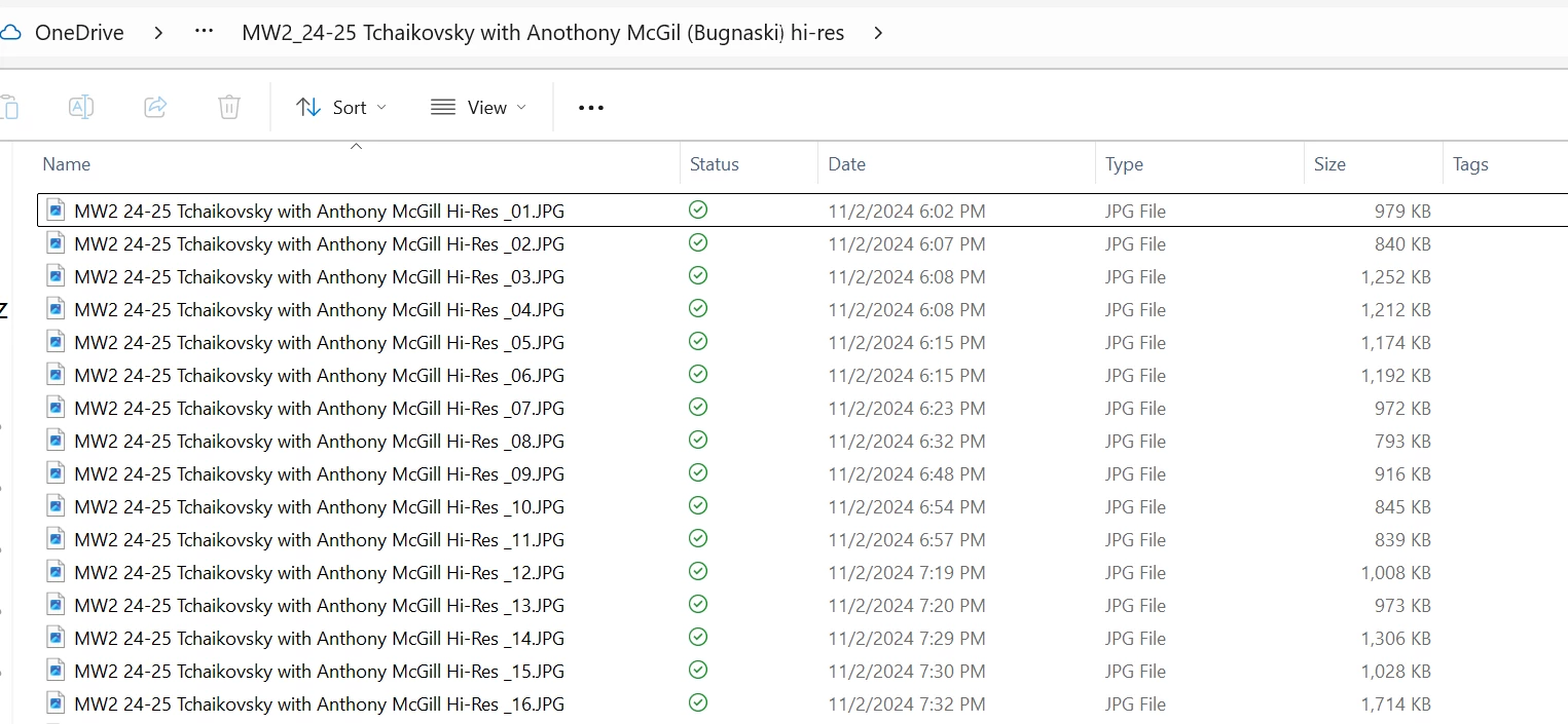

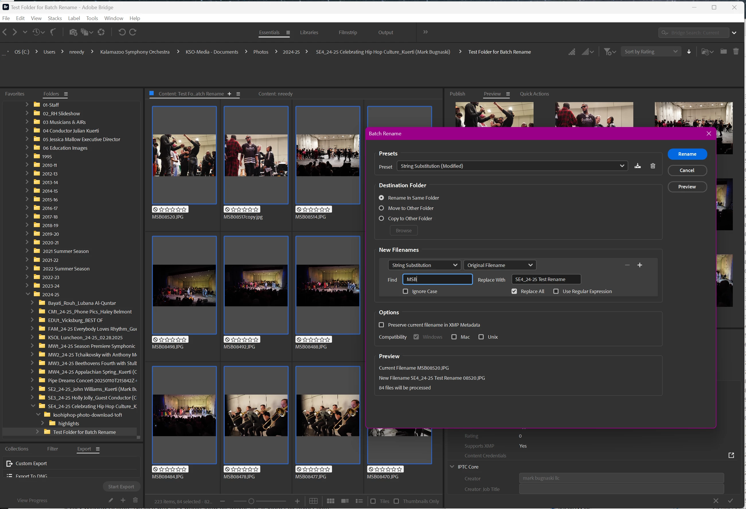

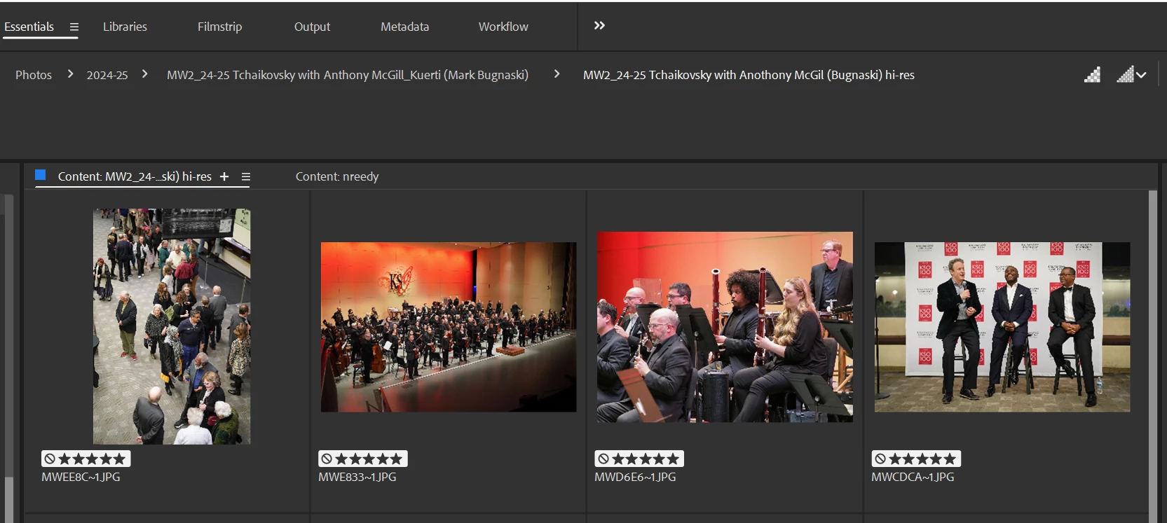

Thanks for your assistance. I am fairly careful to check that the preview name is correct before accepting a batch rename. Since I can't go back and show this same folder (due to the file names now appearing differently in Bridge) I did the same process on another similar folder. This folder has the length of file/folder path, and the files came from the same photographer. In this test, the new filenames I created in Bridge are accurate and match the filename as it appears in Windows Explorer, so I am not able to replicate this error either. I am attaching screenshots:
1. Test of my batch rename on a different folder (folder name starts with SE4) from the same photographer
2. Results of that batch rename in Bridge and Windows Explorer
3. One of my photos from my original batch that has the incorrect name in Bridge, but correct name in Windows
Explorer (note that when I view this image in Windows Explorer the filename is "MW2 24-25 Tchaikovsky with Anthony McGill Hi-Res _11.JPG" but when I view the same file in Bridge or when I upload the file here or view it in an adobe library the filename is "MW4BDB~1.JPG"
4. A screen shot showing the differing filenames between Bridge and Windows Explorer (the image I uploaded is from this folder)

Please post screenshots of your Batch Rename settings as well as the folders in question.
