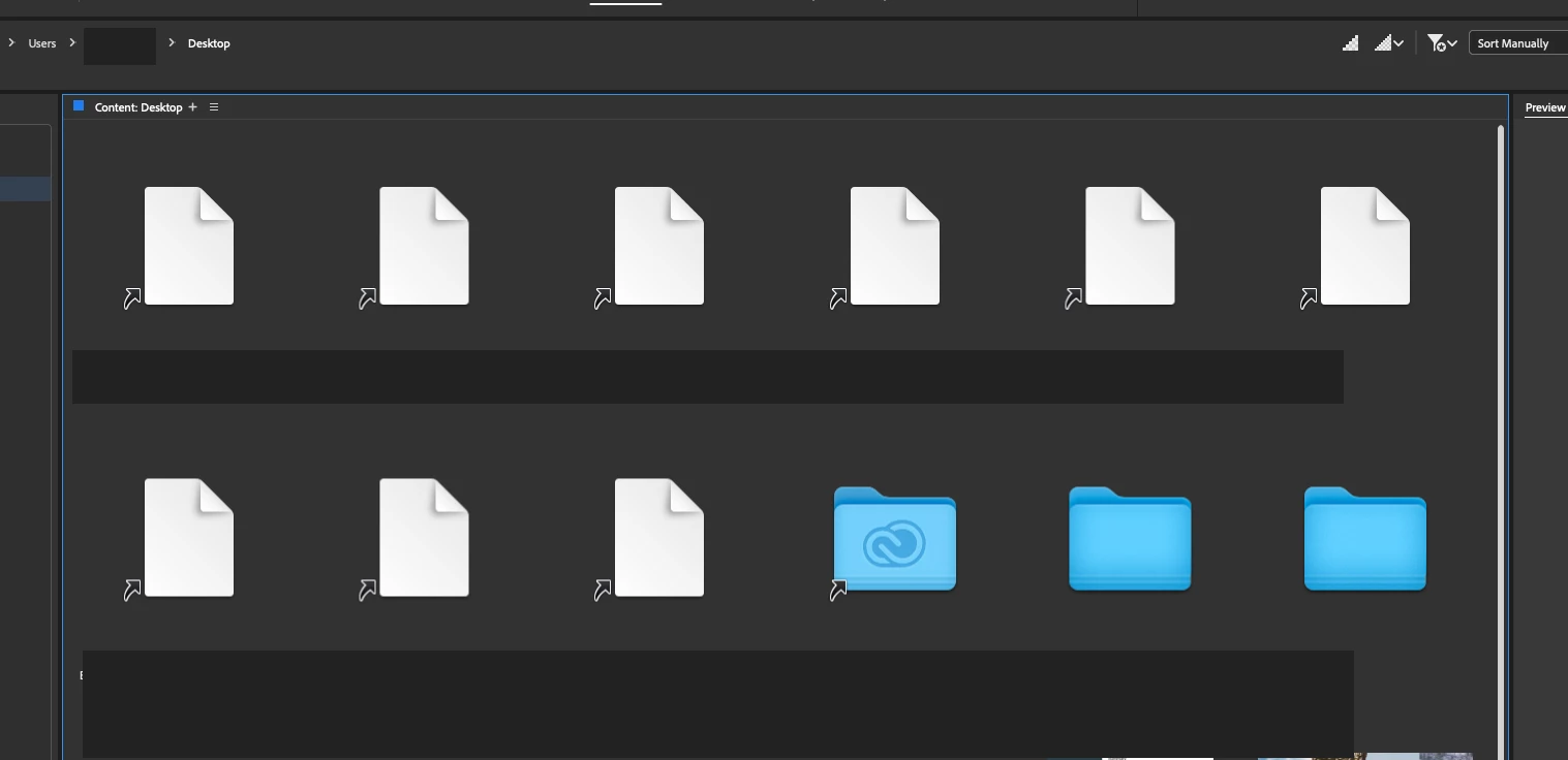

Any files that have that use and alias are not showing on Bridge.  I have v.14 and have purged the cache.  Please see the screen capture and advise how I can fix it.

... solved it.
its a thing of the mac finder.
I have first to change the folder icon with a new image and THEN have to make an alias of the folder and THEN have to change the alias folder icon with the same image thumbnail with the original folder.

Thanks for reaching out.
Can you please share the path/alias type which you are using here?
Is there any particular way you are creating the alias?
Are you facing this issue on any particular alias? For ex: are you also seeing these on application alias.
Or any other information, which you think can help us debug this issue further.
