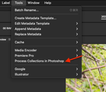

A useful feature of Bridge is the ability to select files in Bridge, and access the Photshop Image Processor via: Tools>Photoshop>Image Processor. That link is now gone, which I'm guessing is due to my uninstalling PS Beta. This is primarly a headsup. I reset Bridge Prefs, which did not restore the Image Porcesor function. I then reinstalled Bridge (deleting existing prefs) this also did not resotre this useful function. I do NOT wish to resintall PS to resotre this function. This is a bub IMO. And I see I am not the only user with this issue.

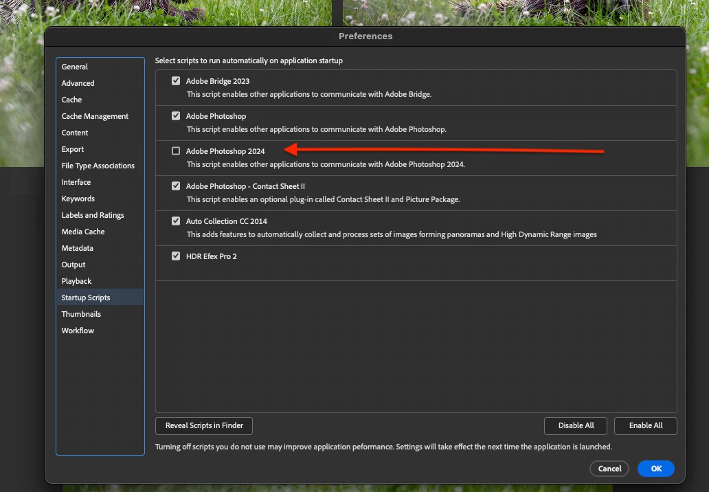

The scripts had been there and loading properly. I also see the scripts checked in the preferences.

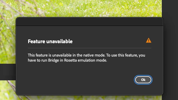

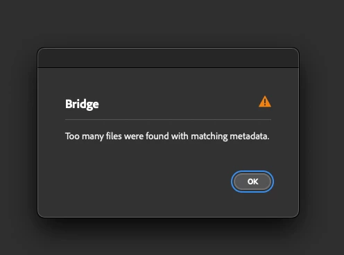

With 2014 enabled in the startup scripts, I get an option to "process collections in Photoshop," but then it tells me I need to run Bridge in Rosetta to use it. Running in Rosetta also fails with the error, "Too many files found with matching metadata." This is with two CR3 files selected in a folder of 417 CR3 files.
