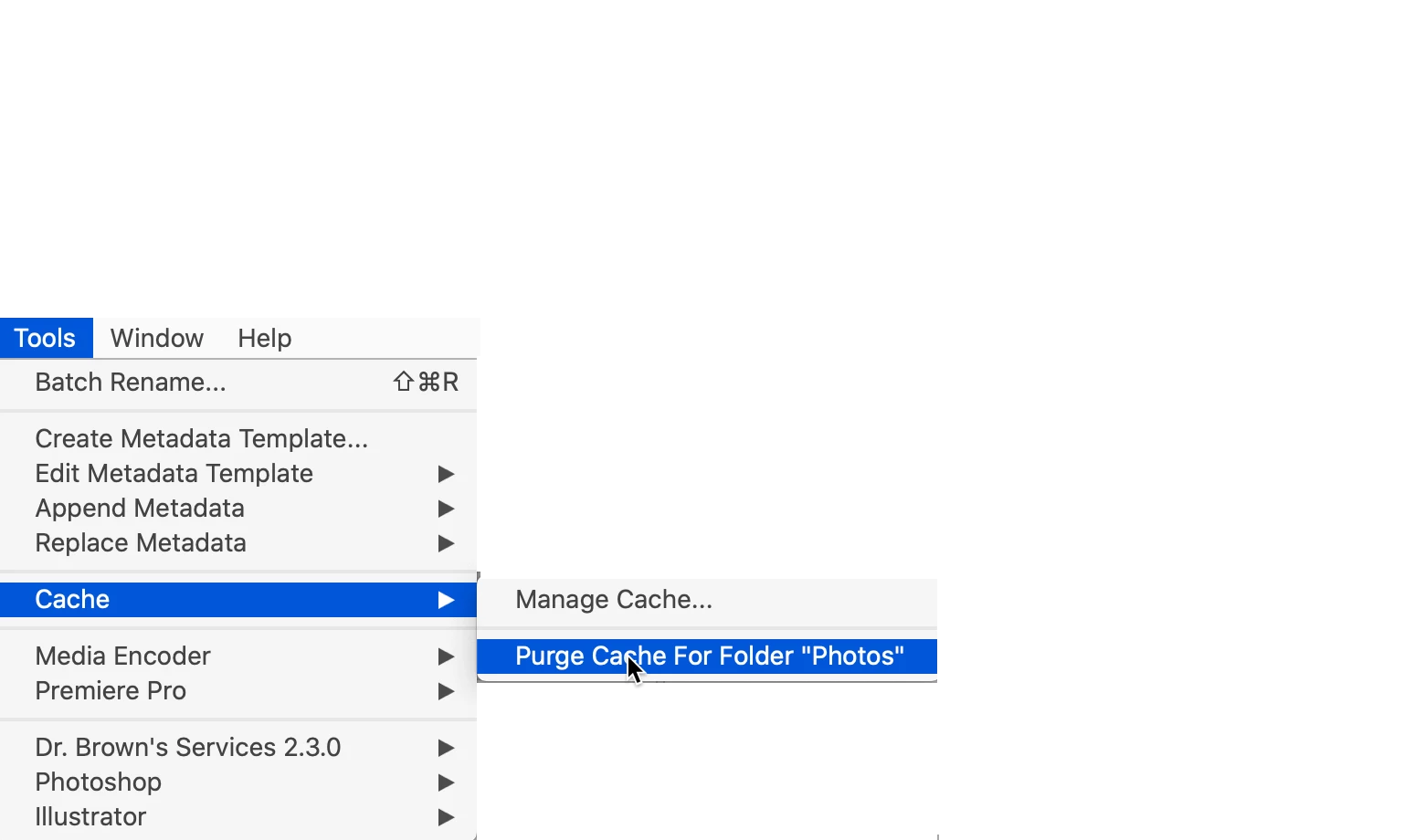

Dec 12, 2020 5:23 PM UTC
Try rebuilding the cache for that folder
