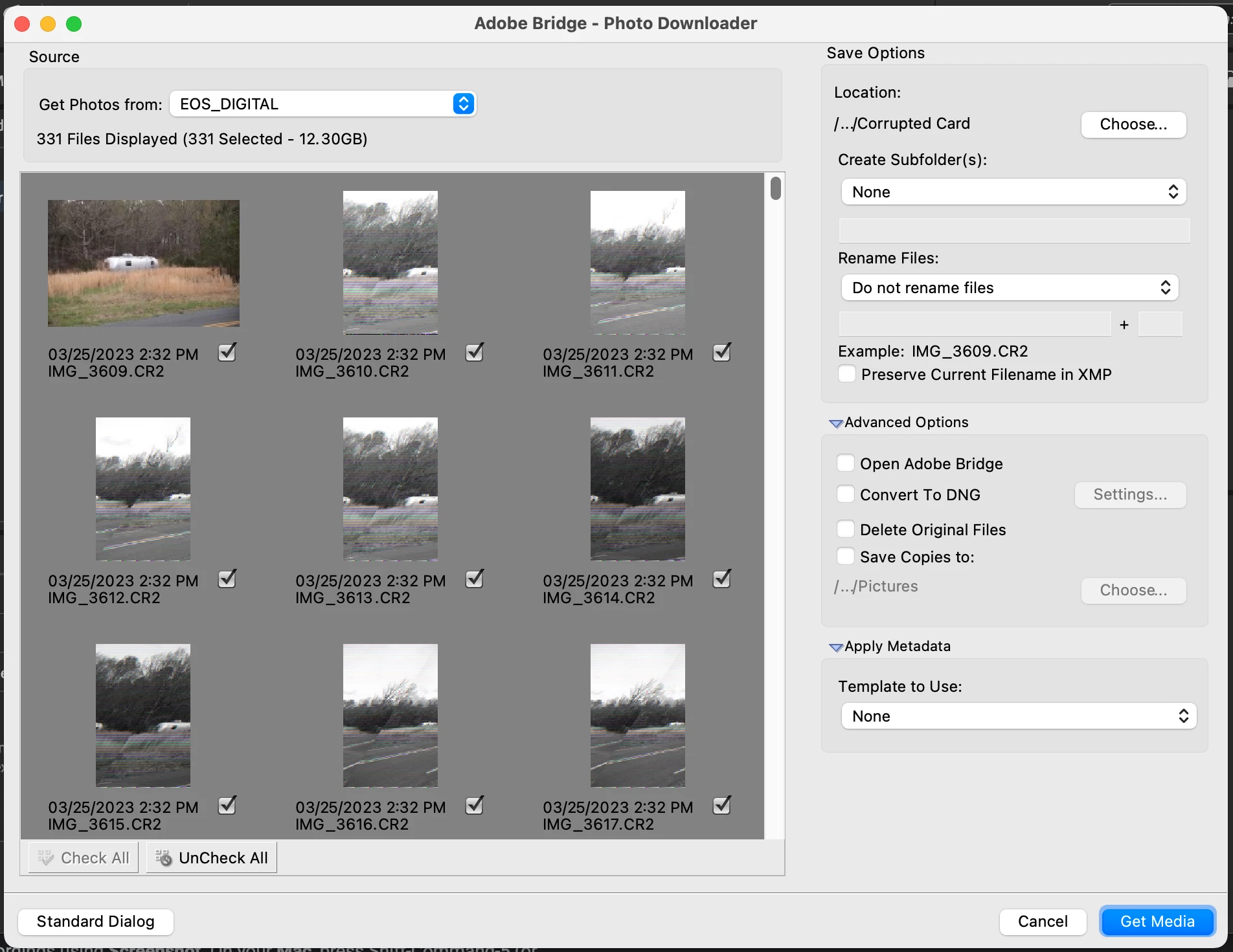

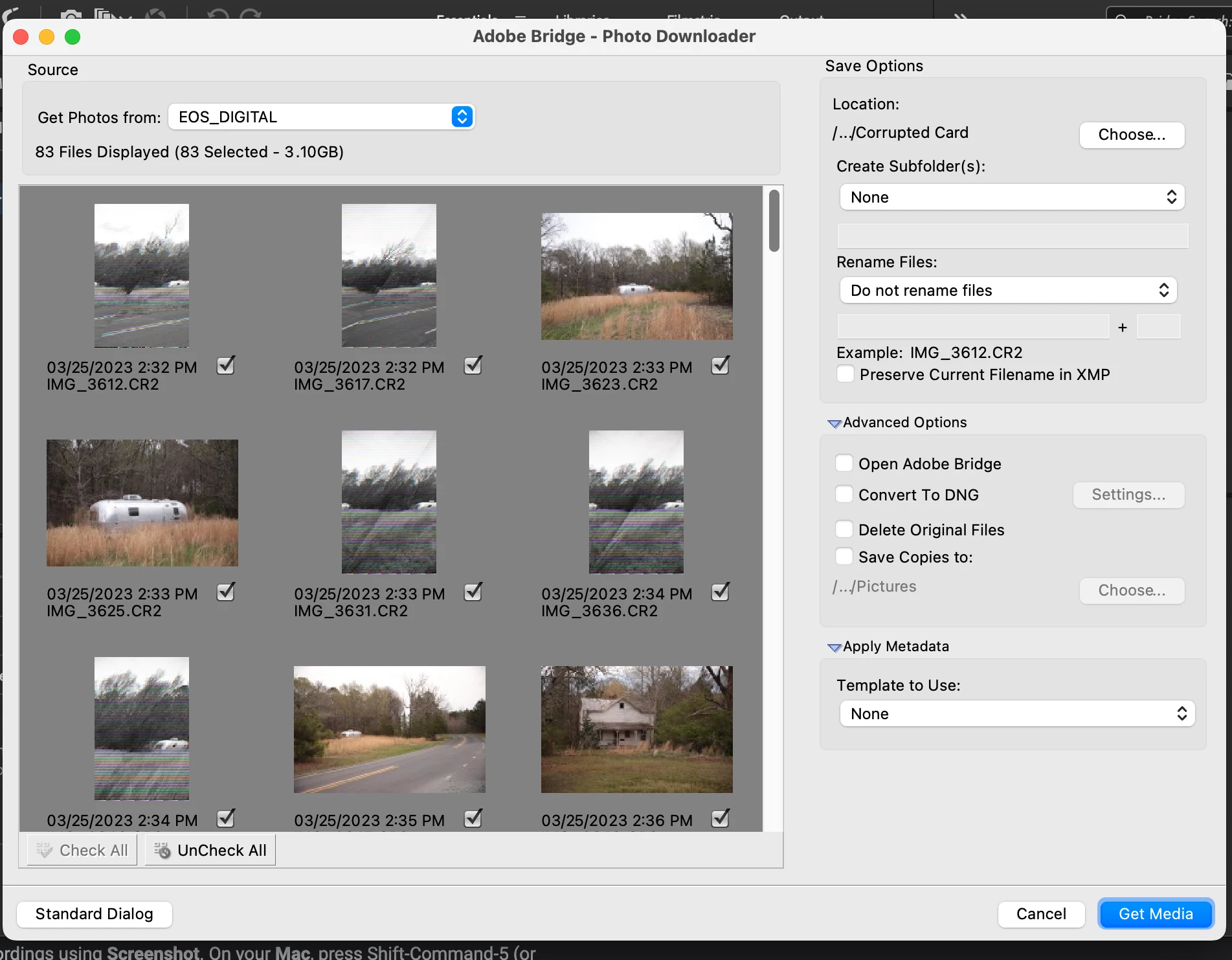

Hi everyone, I hope you can help me out with a problem I am having. I'm not sure why this is happening but whenever I try to use the photodownloader in bridge to remove my photos from my SD card the thumbnails for some of the images appear glitched. They still seem to be perfectly fine files and work fine with everything ive tried it just makes me uneasy seeing the glitched thumbnails. downloader also for whatever reason no longer will fully see all of the images on the card right away. Instead now i am foreced to use the "get photos from" dropdown and hit "refresh list" once if not multiple times before it shows the full ammount of phots on the card. Obviously this could be a problem with my card but i have no idea how to figure out if its the card of photo downloader so i figured i would ask here. The first image below is just to show that downloader is to displaying the full ammount of files on the card and the second image shows the full ammount of images on the card. Thanks!

Well, the first thing that jumps out is that the source is identified as "/../Corrupted Card"
Have you tried a different camera card? (Or is that the name you gave your card????)

Besides the Corrupted Card (still laughing), the other thing I'm seeing is that a number of the images shown in the 2nd screenshot appear to be in B&W. Can you verify that that's the issue your concerned about? After moving to the computer, I gather they are in full color? Am I correct that the upper image, where everyting is in color, was after you "teased" the source several times?
