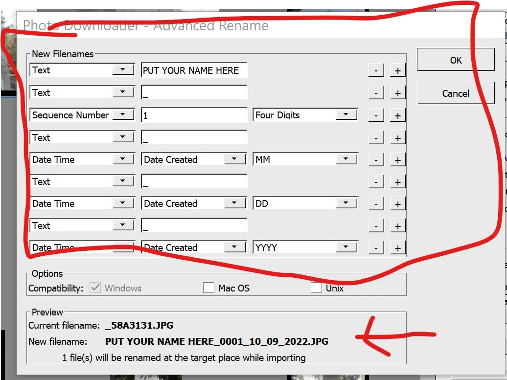

The Custom naming option has the date without spaces--01012022 or similar.  This can be fixed by using the advance rename option to put the date separated by an underscore (_) so that you get the file_name_0001_10_01_2022.

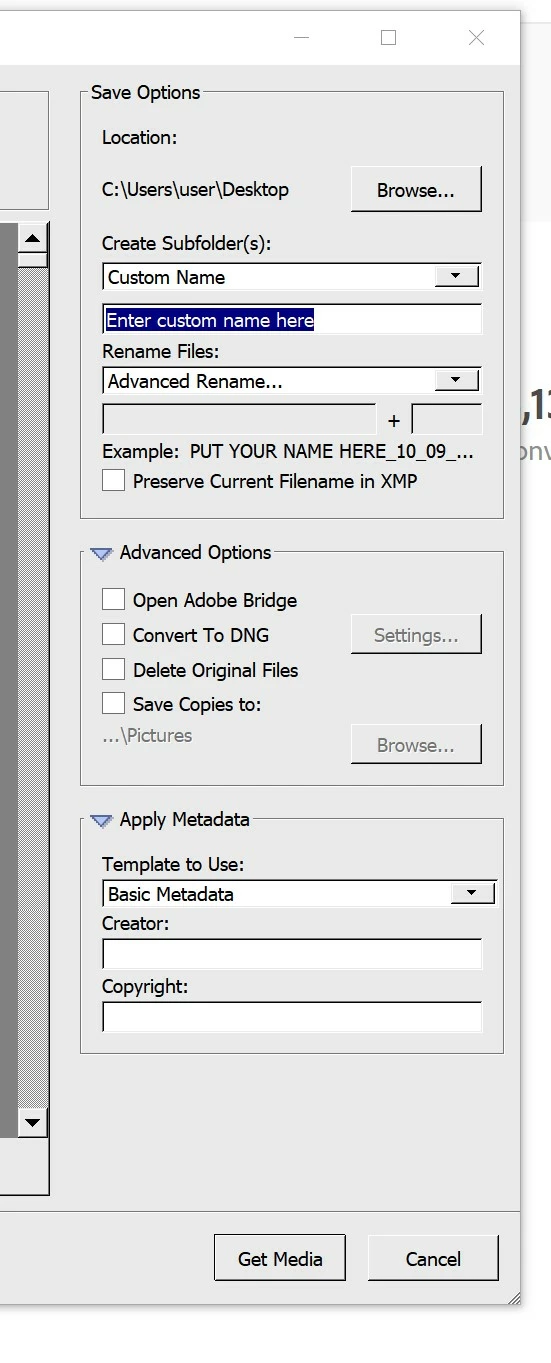

Unfortunately, when you have this set up and open a new card via card reader to download more images, the secondary field where you would put in the new name is not available for entry.  Previous versions of Photodownloader did not have this problem.  It is pretty clunky every time you have a batch of files to download you have to click on the advance rename to get to the screen where you can put in a new name.
