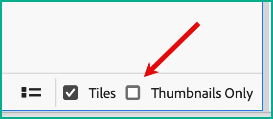

Most common is that you've set your display to show only thumbnails. On the bottom right corner of the Content Panel, you'll see this:
 Uncheck that if it's checked.

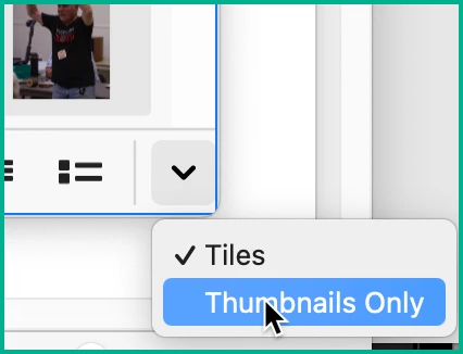

If your Content Panel is narrow, then it will be a dropdown option:

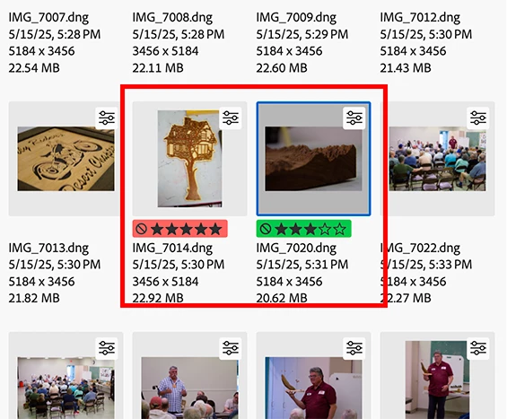

Alternatively, it can be the size of your thumbnails.
Here, I am showing larger thumbnails. Note how everything can be seen.

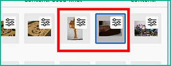

Here, I've made the thumbnails smaller. Note that the labels are still seen, but the ratings are reduced to a single star, and the number of stars is provided.
Finally, at its smallest size, nothing is shown.
