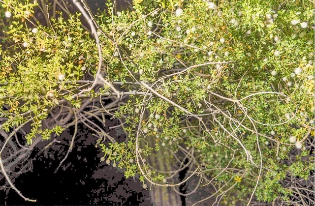

I’m seeing some rendering problems on the thumbnails and full screen views when in Bridge with raw files that have been adjusted. Images look like they often do just before a render is completed, blotches and strange color in areas.
I’ve tried purging the cache, turning off and on Software Rendering in Preferences. When the raw file moves to ACR or to Photoshop the problem goes away but the Bridge rendering still remains strange.
Help appreciated, samples below.
Bridge Rendering (problem in shadows on lower left)

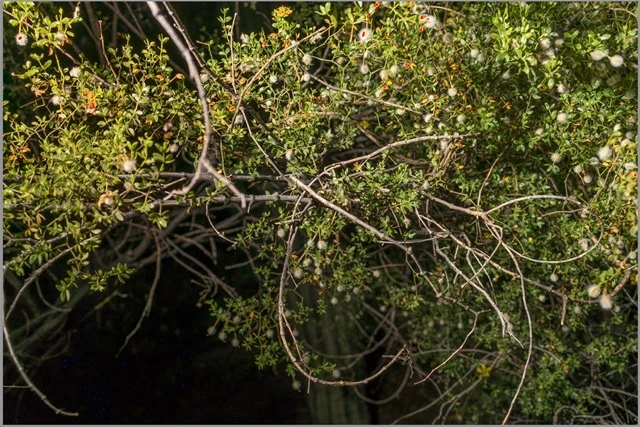

ACR Rendering (problem not showing)
