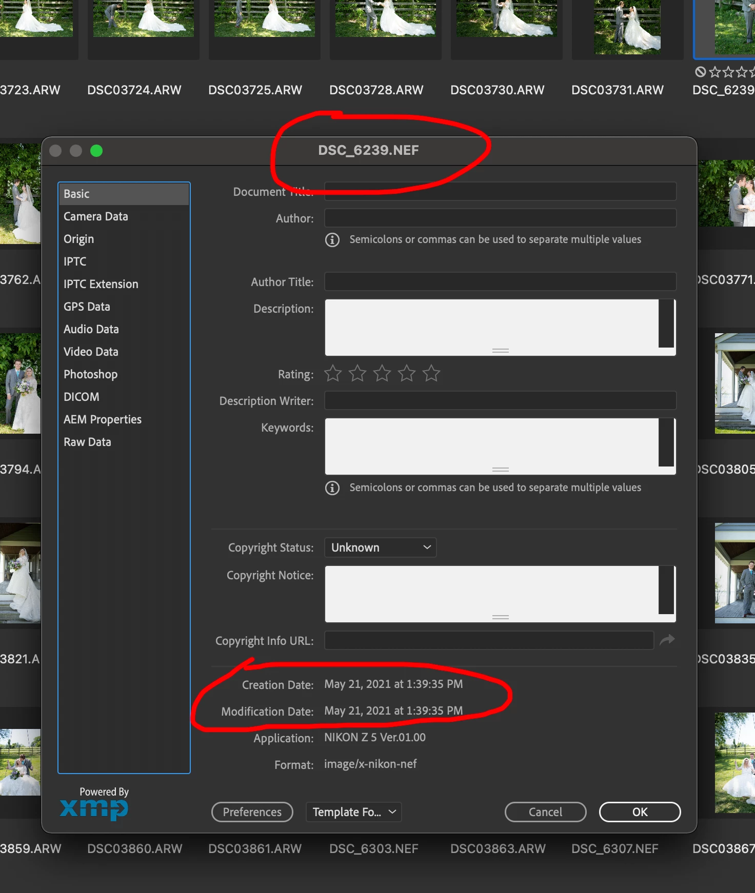

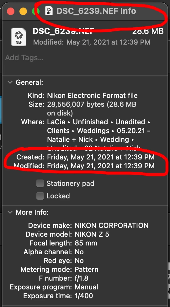

I'm a wedding photographer and my second photographer and I sync our camera times right when we begin the day to ensure everything is lined up when I edit the photos later. She shoots with a Nikon Z5. I have an iMac using macOS Big Sur Version 11.31. When I view the file info of my second shooter's files in the Finder on Mac, the creation date shows the correct time that the photos were taken. But in Bridge, when I click "File Info", it incorrectly shows the creation date as an hour later than the photos were actually taken.
As I can see on my iMac's Finder, it does show the correct time there. But Bridge is showing that the photos were taken an hour later, which means when I want to sort by date created, the photos don't sync up with my own camera's files. I don't understand why Bridge is showing an incorrect time but my Mac's Finder is showing the correct time. Anyone know how to fix this?

Image files from a camera have multiple date/time fields. Those include modification date, creation date, and date/time original (capture time.) If the clock is off or DST doesn't match on the cameras and computers, you can get an error. Bridge does allow you to edit Capture Time and various file utilities can change created and modified dates.

It might be that one of the cameras is set to record the time zone or daylight savings as part of the time metadata. Mac OS is compensating for this but Bridge isn't.
May 25, 2021
The camera does not have Daylight Savings turned on.
May 26, 2021
I should have said files from both cameras.
I haven't seen this problem in Bridge so I was curious if the raw XMP CreateDate and ModifyDate are correct in files from both cameras. If the XMP date/time is correct, then we could try to figure out why it is not displayng correctly.
My camera's file times are correct in Bridge. My second shooter's are off by one hour.
