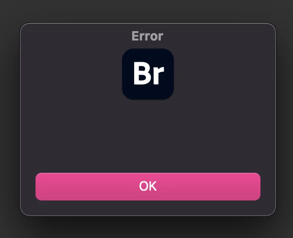

Bridge shows empty error message and does not start
I have installed Bridge on a Desktop PC with Windows 11 Pro (Version 10.0.22621) and ATI Radeon HD 6450 Graphics.
When starting Bridge, it shows an empty error message and after confirmation, there is no reaction in Bridge.
Task Manager shows status "inactive" for Bridge.

Same error:
MacStudio 2022 M1 Max
macOS Monterey 12.6.3
Bridge 13.0.3.693
Jun 27, 2023 12:19 PM UTC
Issue seems to have started after trying to open images from SMB network share.
Completely deleting all preference folder "Bridge 2023" seems to have fixed it:
~/Library/Application Support/Adobe/Bridge 2023/
Jun 27, 2023 12:30 PM UTC
Issue comes back after connecting to SMB share.

I've had the same problem on one Windows 10 Pro PC, uninstalling and resetting prefs hasn't helped. I have access to other Windows and Mac computers and it isn't happening elsewhere. Small blank alert dialog on launch then crash, no logs generated. I was able to get some at one time and they indicated the heap (programming memory structure) was corrupted.
