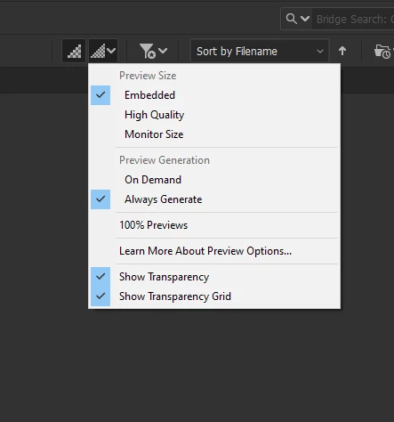

I have had the same issues with bridge for a while now till i hit upon a setting that made bridge behave itself back to somewhat normal 🙂 it was basically the thumbnails of especially RAW files that were putting 100% load on all my CPU cores and the CPU temperature shooting upto 85-90 degrees resulting in crashes sometimes.
Try changing the preview size from High Quality to embedded and everythign should come back to normal and speedy check the attached image

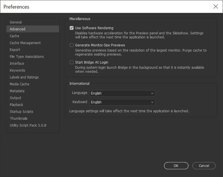

Have you tried this setting?  It may help.How many files are in each folder? Are there any video files in the folders?
Dec 12, 2020 8:07 PM UTC
I will, but since it affects the entire program, not just images, I don't expect it to help. No files were added or changed from one day to the next. It was fine, then not the next morning.
