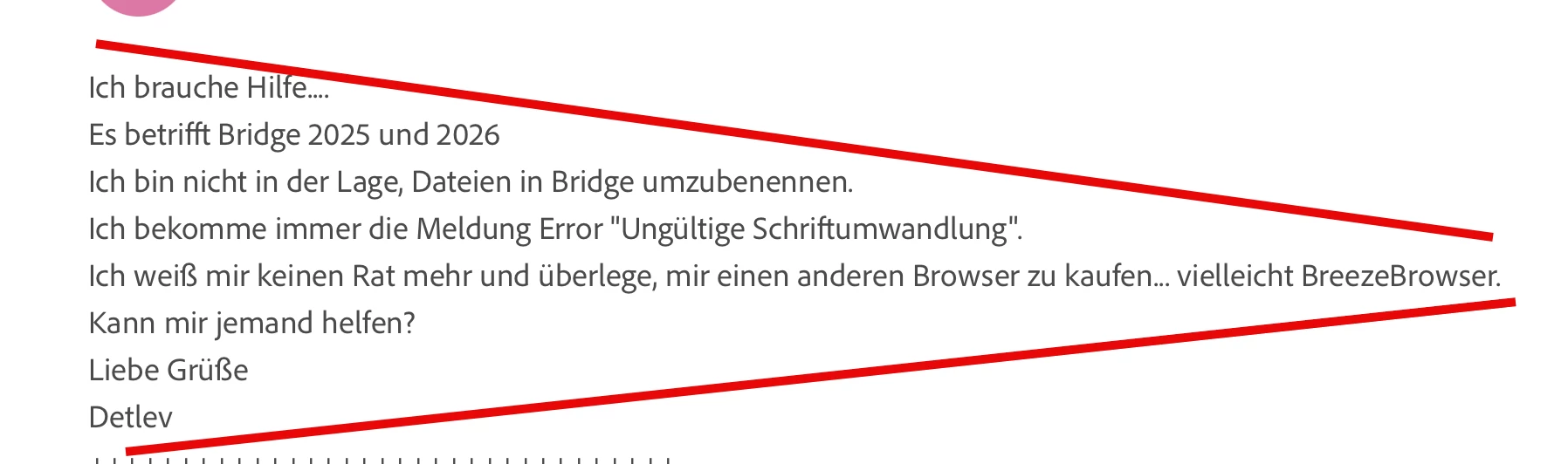

 If you rotate that 90° CCW, you get this:
Perhaps I should have said "rotated" pyramid.  That's what I was referring to, that's all.
But, back to your issue: I was hoping for something obvious, but I'm a Mac user, and I do not know how PCs set fonts when in use by applications. I am sure that one of my PC-Expert friends can come in here and provide more help than I can. Fortunately, via your answers, they should be able to come forward with something.
