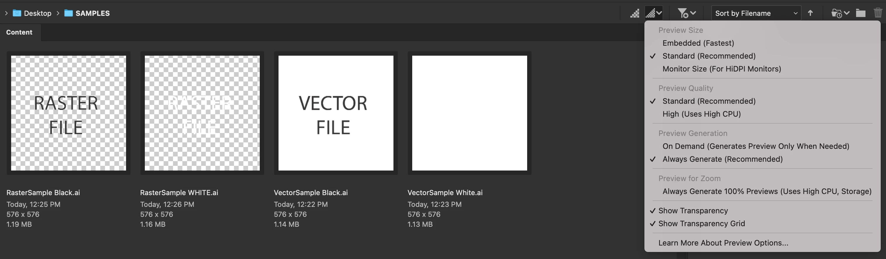

Bridge won't display transparency on vector .ai files
  • February 4, 2022
  • 233 views

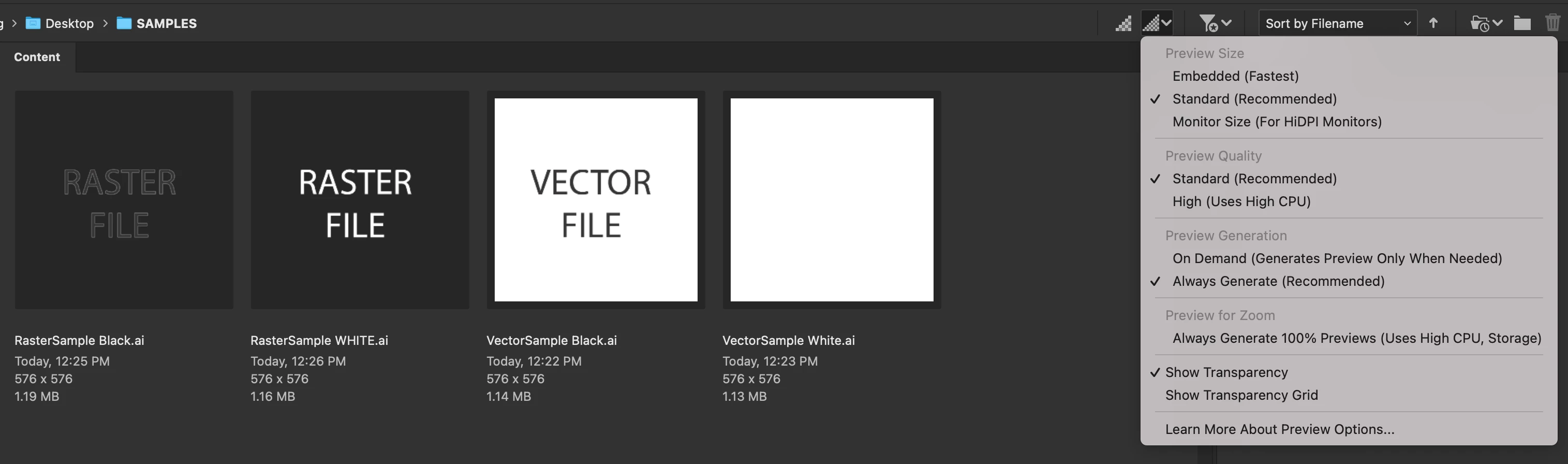

As you can see in the examples, bridge will not display transparencies in .ai files unless it is rasterized.  I have white vector .ai files that will only show up as a white box.  I can save it as an .eps vector and it will display correctly, but I want to use .ai files.
